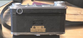

Gary, thought you might like to see my Contax II that came back from a CLA (much more than that really) today. Thank you Ed Trzoska for the fabulous work.
1936 - it has aged well.
