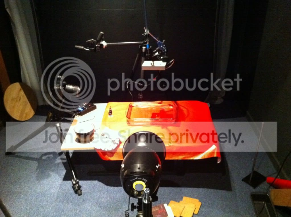

Here is it setup for the first time in it's entirety:
and the result:
This is just using natural light and the D200 (I was taking the pictures of the setup using the D700).

Wail,
You need something that stores water and allows it to drip out (in my case a burette).
You then set this up so that the drips fall through the hole in the water drop detector breaking the light beam within.
You then turn the sensitivity control until each water drop lights the LED.
The water drop detector is then connected to the universal trigger interface and the interface connected to the camera.
You then run one of several supplied routines:
INSTANT
TRIGGER
INTERVALOMETER
SOLENOID
in this case TRIGGER...
You then set:
the number of repeats (just a large number will do)
the camera port ON
the camera delay to say 100 milliseconds
the flash port OFF (the flash is firing from the camera in this example)
the repeat delay
Then the camera is in MANUAL mode setup as you would for a studio and MANUALLY focussed on the point where the water drop will hit.
Then you start the drips......
As each drip goes through the device it waits for (camera delay/1000ths second) before it fires which will give the drip time to fall into the water bath underneath.
You can see this in the rear screen of the camera.
By adjusting the CAMERA DELAY setting up and down you whilst it is working you can set it so that it takes the picture at just the right time for the effect you want :)

After John left I set it all up again finding a better setup that was a tad more stable.
Basically you can see a lab stand G clamped to the cross member on the roof pointing downwards and to this is a burette clamp and burette. Also attached to the stand is a manfrotto super clamp / arm / second super clamp. In the super clamp is the water droplet detector. This is all connected up as described earlier with the Lencarta Smart flash studio light being triggered using a radio transmitter as I couldn't find a 3.5mm to 3.5mm studio light cable at the time. (the portable trigger control unit has a socket on it to directly control the studio light BUT this socket also acts as a solenoid control socket so when using solenoids you only have the camera socket. This isn't an issue as you can control the light with the camera OR alternatively I will be selling a camera output socket to flash adapter & a camera output socket to HIGH POWER flash adapter)
