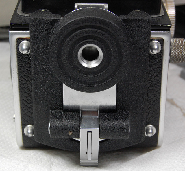

If that's the one from Kent, you got a really good price on it. With old Rolleis (and any other TLR), make sure you check that the alignment is correct (i.e. that one lens is straight against the other), that all four feet and the film door back are not caved in (could've been dropped), that the focus stops at the hard points (doesn't go past infinity, doesn't go past closest focus distance) and that the bottom hasn't been warped (could indicate that instead of using the proper Rolleifix tripod attachment, the person just attached the camera straight to the tripod).
that is the one :), that is this rolleifix widget then?
It's an attachment that secures to the bottom of a Rollei(flex/cord), which allows proper weight distribution of the camera when connected to the tripod. Most Rollei's have a tripod thread screw in the base, but it isn't actually meant for tripod use and incorrect use of it can cause warping, as the weight of the camera buckles around the tripod connection.
They look like this (in the middle of the two black circles):
I'm a bit confused, does the camera in the photo above have the tripod attachment fitted or not?
Nope - with Rolleifix it looks like this:
Ah, I see. That looks like a fairly major attachment, does the same thing apply to other TLR's?
I'm not actually sure. I've used my Yashica Mat on the tripod socket on the bottom, but I've only heard of it being a necessary attachment for Rollei tripod users.
