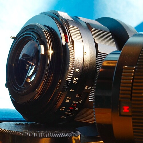

This relies on something that was patchy on M42 lenses - M/A switches. You should be able to make it out in this picture:
With 3rd party M42 lenses it was a bit hit and miss whether it was included.
As above the lens needs to have an Auto and Manual switch to stop down the aperture, later ones tended to not include it and only had the auto mode because the function was included on nearly every M42 camera and most provided the ability to stop down using the depth of field preview.

No sign of any Auto/Manual switch on the lens.:(
