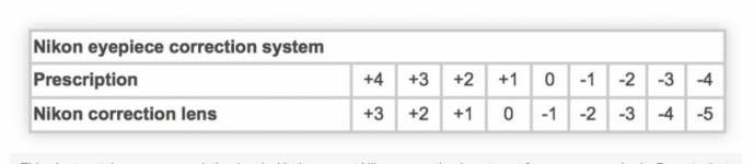

At the end of last week I received a rather nice Nikon F3HP.
At 55 my eyesight needs a little help - distance is fine but I need reading glasses with +2.00 diopter correction.
I would rather not wear my glasses to use the camera so I bought +2.0 Nikon DK-17C viewfinder lens.
To my great surprise this makes viewing of my viewfinder considerably worse.
Now I know the F3HP has -1 diopter dialled in as it comes from the factory.
What have I missed here?
I was expecting my +2 lens to give me a clearer viewfinder image, not worse?
Anybody experienced something similar?

Hmm...found this table on fstoppers.
I guess it's worth getting a +1 to see if that is the answer - but the Nikon description says not, i.e. a Nikon +2 diopter lens gives that final value on the camera.

Just spoken to Grays of Westminster who happened to list a +1 in stock on their website.
They think the above table from fstoppers is the RIGHT information.
Anyway I've ordered the +1 from them so will see what it does when it arrives in a couple of days time.
To round this off.
I have just received the +1 diopter correction lens and installed it in my camera. For me it's a good solution - the clarity of the viewfinder seems perfect to me now without my glasses.
So it would seem that Nikon's now information on its website is a little confusing and the table I have posted above from fstoppers is good guidance.
The issue was most likely distance... Your +2 diopter for reading glasses is probably for about 52cm, the image in the viewfinder is set at a distance of ~ 1meter. And if you are farsighted, the diopter required reduces as the distance increases.

Interesting, the first article says to get/use a diopter measurement for 1meter, and the second says to use a diopter of 1 less than your prescription.
