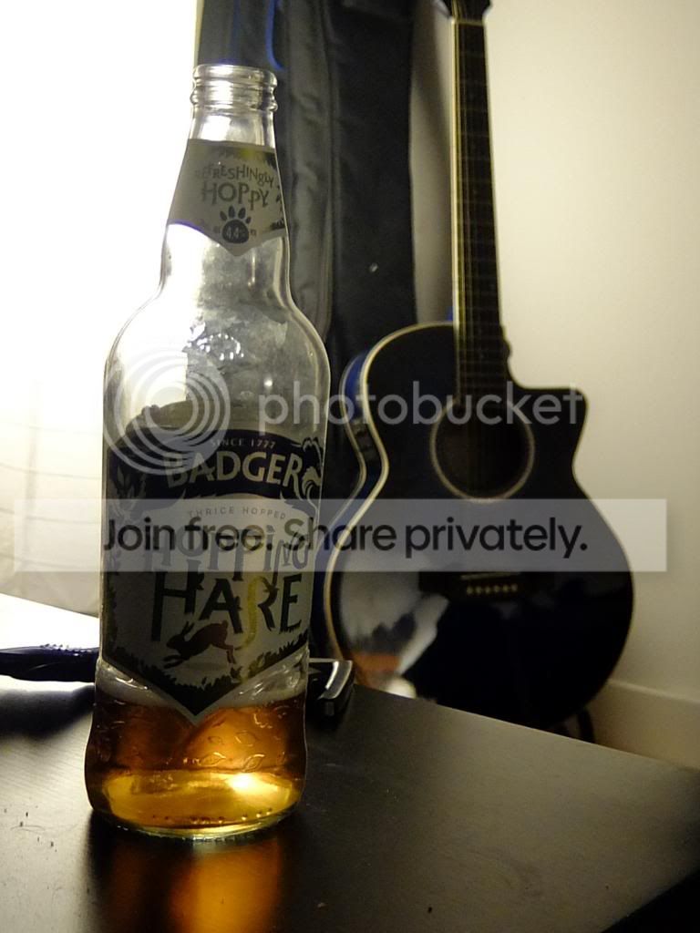

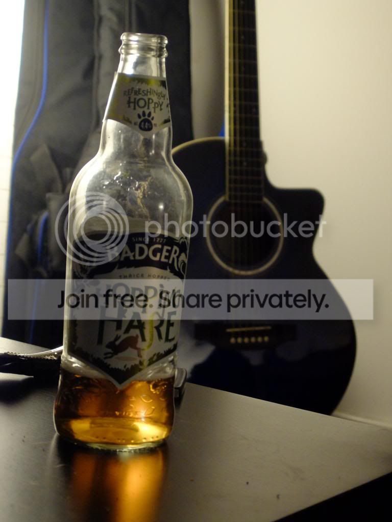

Ok, bear in mind its 1AM and I've had a beer and this is by no means scientific but hopefully it will demonstrate well enough :D
Both of these photos were taken from the same camera position, the first one was cropped and the second one was zoomed in.
As you can see, in the zoomed one the guitar appears much closer to the bottle than in the cropped image even though both were taken from the same camera position and have roughly the same subject size. Without the camera movement and focal length change you don't get the same dramatic change in perspective as seen with my beer.
Obviously I've done nothing with moving the camera and you will get very small changes in perspective as you move the camera back and forth but nowhere near as much as movement plus zoom.

You have seriously weird zoom lens. From a fixed poition, size of objects won't change size relative to each other. Changin focal length simply alters the field of view.

The camera was on a tripod and didn't move between shots. You can see that the perspective is identical. Check the focal lengths on the Exif data. The objects are about 1.5m apart.

That's very strange, I didn't have mine on a tripod so it's very possible that while fiddling around with the zoom I moved the camera!
