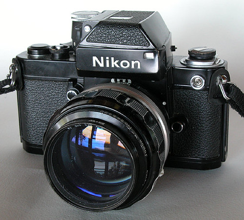

Nikon F2 - the rabbit's ears are linked to a metal pin under the Photomic Pentaprism head just out of sight... lenses such as this are known as Non-AI since the introduction of AI lenses in the late '70's...
