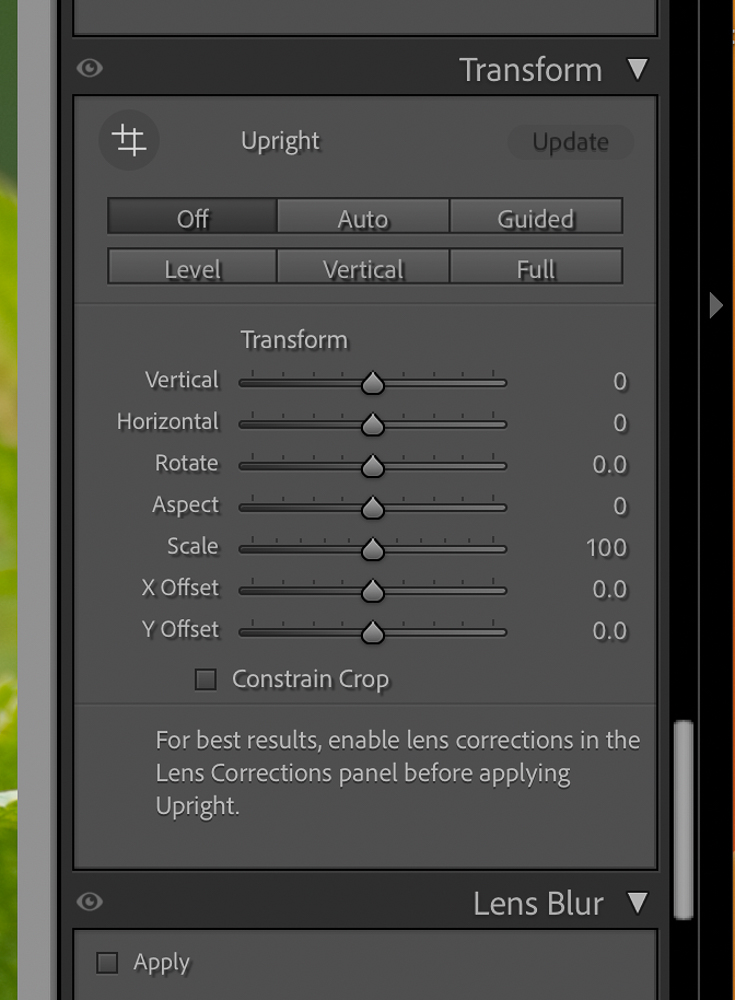

if you use LR, this helps - sometimes it's effective but you loose some of your image
