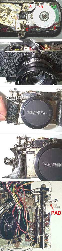

The contacts used to activate the meter depend on the shooter trigger's mechanism and will be affected for the "Pad of Death", so you have to check if your camera suffers from that common issue:
http://www.yashica-guy.com/document/repair.html#nine
As shown in the last picture:
If you are a very patient person, then maybe you will be able to remove the old pad and replace it for a new one without fully opening the front of the camera, accessing from the top as shown in the following picture:
If not, then you will have to fully open it, but the good thing is that it is possible to do it without cutting any cables, as shown here:
I am not a "handy man" and I was able to repair it on my own Electro 35G, if I can do it, anybody can, just follow the instruction from the Yashica Guy.
I hope this helps.
