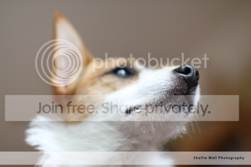

They're much better than your early shots. I have the f/1.4 and to be honest it's really only worth using at f/2 or smaller unless you accept the shot won't be that sharp.
The photo of the dog is a vast improvment. Try to focus on his eyes and use an aperature of say f/4, then f/2.8, f/2 and f/1.4 and see what you like the most.
I think you were compressing the files too much, which is why some of them shown what you called noise. ;)
They were also lacking sharpness, but it seems you are now solving this problem.

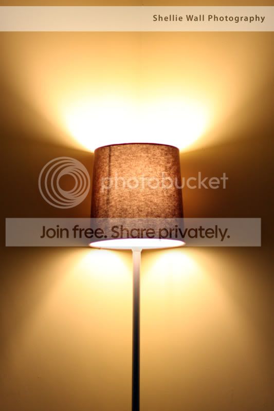

ok this was the last try and it was after a good half a bottle of wine......

hows that??
It doesn't look sharp Shel, probably I suspect because you haven't sharpened the image after you've reduced it in size. This will always need doing with any image from any lens because when you reduce the size the image loses resolution (sharpness). In short it's hard to determne from that shot how sharp you got it.

hows that??
Looks soft to me.
Presuming you are about 2 metres away from the lamp your DOF is 5cm ! @f/1.6
If you want the whole lamp in focus, you'll need to change the DOF to 5.6 - 8.
See this useful calculator. http://www.dofmaster.com/dofjs.html
