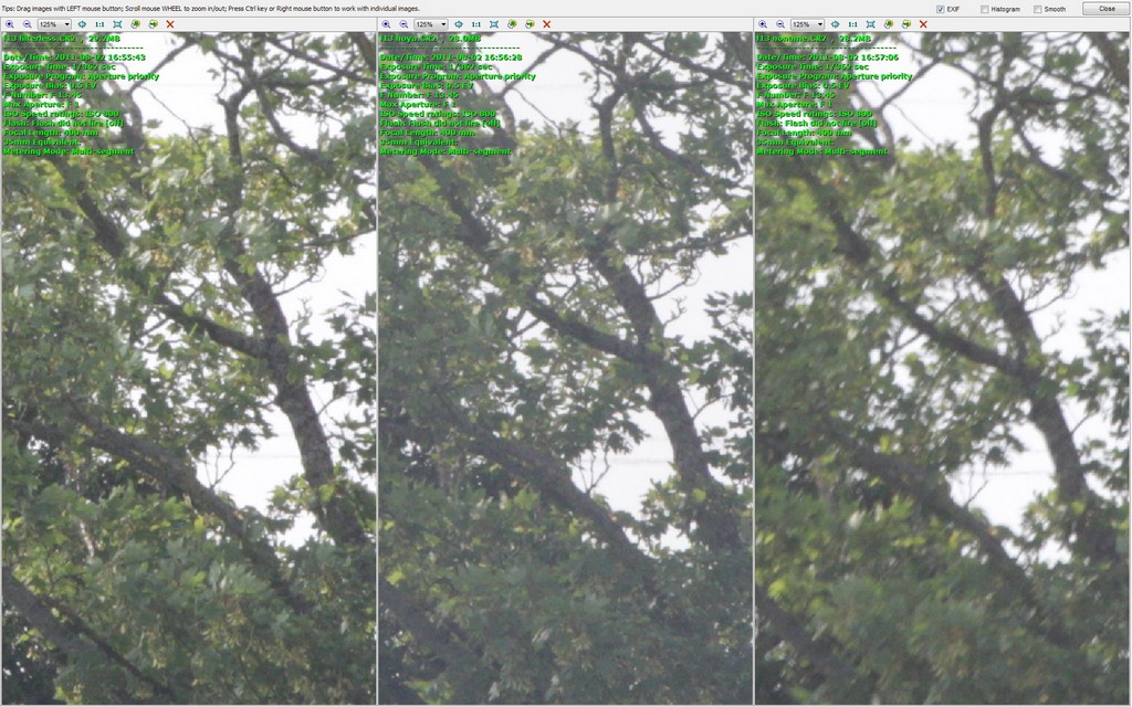

The other aspect of image degradation which you illustrate is nothing short of alarming! I am finding it difficult to believe but can't read the tiny green print on those three images.
Note that I am not using a UV filter, nor recommending a UV filter.
I can quite easily read it by zooing in on my browser. The three images were taken within 1'30" and f13, Av, with no hood. The centre image is with a Hoya HD - one of the most often recommended 'protective' filter. I bought one because it is very tough and I was shooting my friend on her horse - and there were lots of stones flying about. I'd have taken the risk, but I was using her 70-200. I was surpised that the degradation was so obvious.
I first discovered how horrible 'protective' filters can be when I had my 70-300 DO. I was going to return it until I removed the filter (recommended by the man in Parks) and I've been anti- them since. I've also never believed the advice I got from salesmen of internet 'experts' - I always try and see for myself.
There is virtually no difference between the two types of filter UV and Protective. Ordinary glass does a good job of absorbing UV. Indeed, if I were a filter manufacturer, I would only make one type and change the label on it (making sure I added the magic word - 'Digital' - to the 'Protective' packaging).
