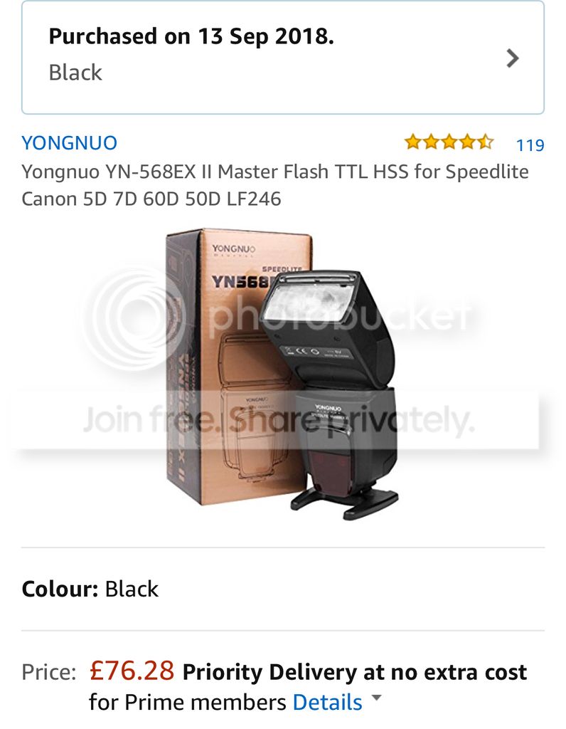

Thanks guys
I’ve just ordered this
I mentioned to the girl that I’ve not had much experience using low light and I said I’ll get better over the next 4 weeks and she said it’s absolutely fine and would be happy with iPhone pics

Does your flash have a focus assist light function?
Flash recycling times are faster with the best batteries you can find - eg Sanyo Eneloops.
