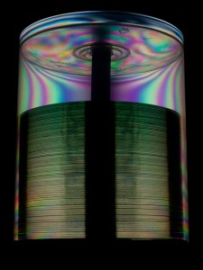

Here's my week 1 entry, with blurb :)
Accommodation
(click to enlarge)

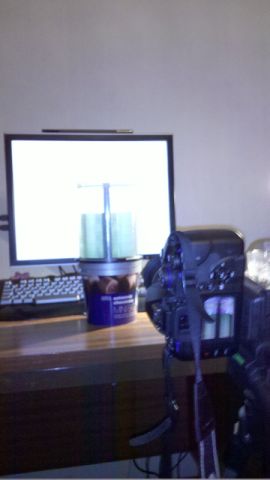

This subject originally frustrated me, since I was hoping to avoid simply taking a photo of my house or my room, but I wasn’t succeeding in finding a suitable alternative. Since it’s the first week, I decided to look on the Talk Photography forums for a little inspiration, and found James306's novel interpretation. Now I looked frantically around me, searching for any kind of casing or housing. I eventually settled on a spindle of CDs, since I would be able to apply a little science to create a novel photograph.
The effect you see here is real, not photoshopped, and achieved through polarisation. Clear plastic tends to produce strange colours when you shine polarised light through it, and this can be seen easily on a photograph. The set up here was setting up the spindle in front of my computer monitor, which was showing a blank white screen. LCD panels produce polarised light, which is exactly what I needed. The camera was set up facing the monitor, and fitted with a polariser filter. By tweaking the polariser’s angle, it’s possible to cancel out the monitor light to a near-black, and by underexposing a little I achieved a perfect black background. The light that moves through the spindle casing and CDs themselves is reoriented, and therefore becomes visible, with bright colours as a side-effect.
I do feel guilty for perhaps taking too much liberty with the given title, but in retrospect this was a lot of fun. Looking at the photo now, it also invokes some idea of sky-rise architecture, so maybe this angle wasn’t so crazy after all.
Here's a pic of what the setup looked like:
Brilliant Jan. :clap:
Setting the bar very high there. Keep it up.
Hope I can get somewher close to this at some stage.
Great to see all of the different interpretations here btw.

Forgot to mention that the description and pic of set-up is v helpful, Ta.
very nice work, it is a stretch of the themes meaning like you've mentioned - but it's your project so I wouldn't delay from doing it again.
