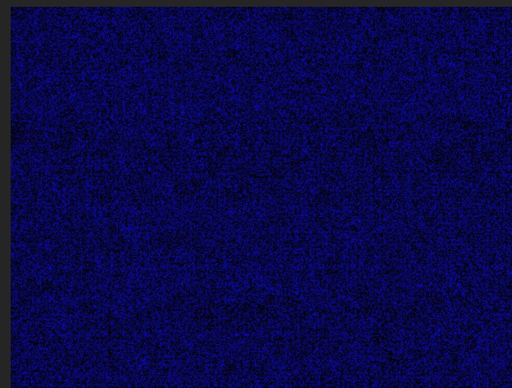

test method:
I took a completely black photograph at night in a dark room on my Canon 1200D with a lens cap on to capture an absolute black image. this image was later put into post processing software to show the peak blacks. the following image is the result, ofcourse the remainder of the image is the noise in the image.

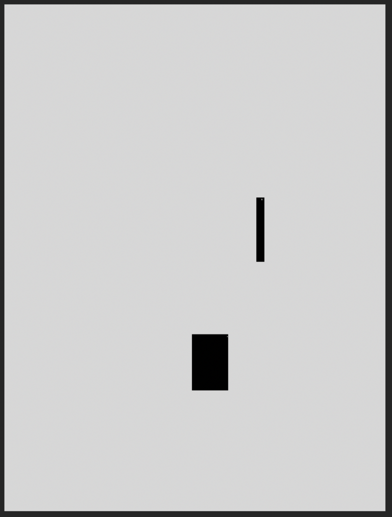

later I repeated the same test with my iPhone 11 and got a completely abstract noise pattern. the white sections being the noise and the black sections being the complete black.
the Canon shot in RAW and gave a natural noise pattern (highly compressed may I add) whilst the IPhone shot in JPEG and gave blocks of noise...
I'm assuming that I'm looking at noise due to the fact that both photos were taken in absolute darkness.
can anyone help explain the result from the iPhone? is it due to the fact that it had been shot in JPEG or is there another factor I am unaware of?

I'm not a phone camera user and the following is simply based on papers/reports that I've read.
The 1200D captures a single image and you can process the raw file as you see fit,,,changing the noise profile alongside many other properties.
When it comes to the iPhone, things works quite differently. The phone continuously captures a series of images from the moment that you enable the camera function. When you take the photo it already has a whole buffer full of images to work with and starts processing. This entails picking the sharpest, the brightest, the best dynamic range, the cleanest etc.
After applying various filters based on the perceived scene....eg, skin smoothing if a face is detected......it then combines the stack to produce the final jpeg. The noise reduction is selective and not global....ie, it may apply different NR in the dark areas of one of the stack whilst smoothing the lighter areas of another.
In short, the 1200D gives you the image that you took whilst the phone camera gives you the image that it thinks you wanted. I can't explain the block noise other than to theorise that the phone doesn't have enough data to make its normal intelligent analysis.
