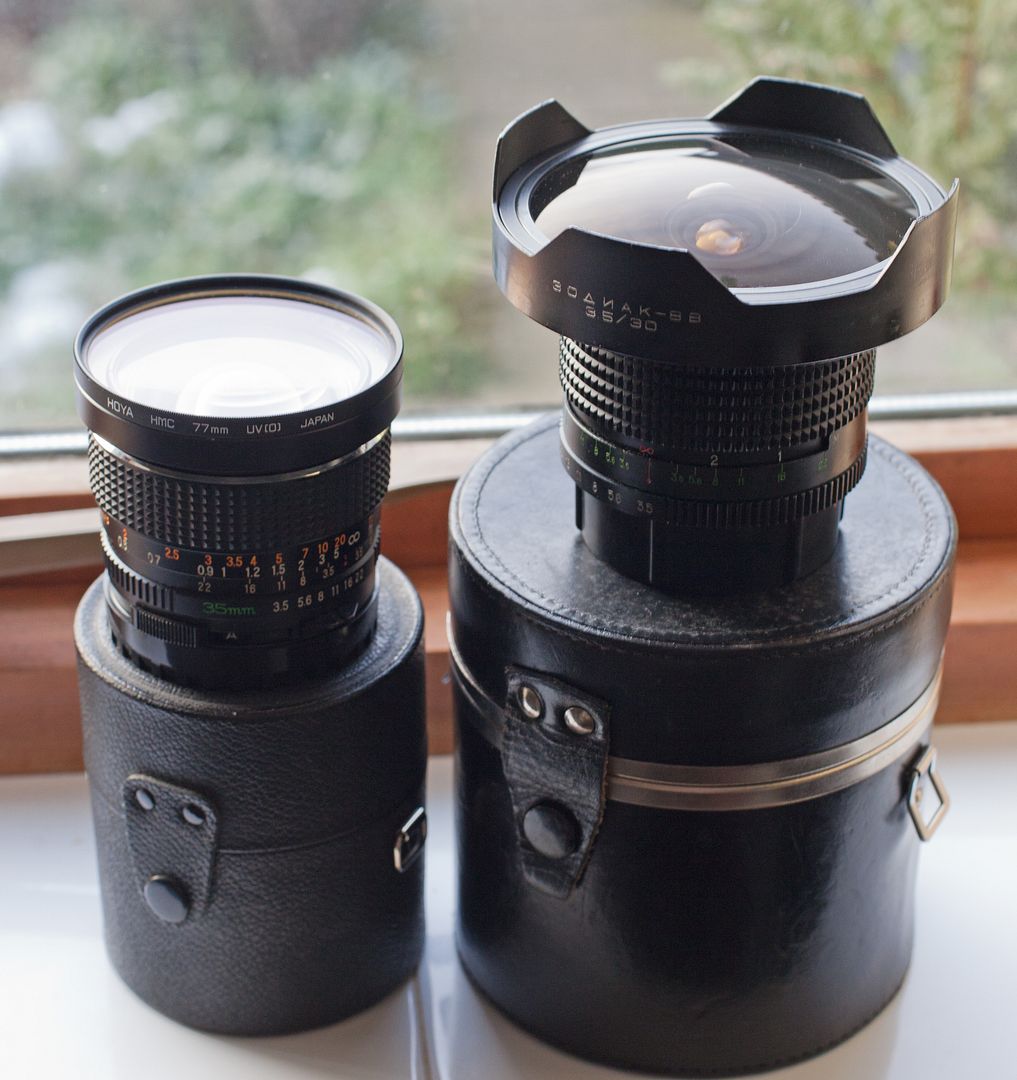

Sitting next to the Mamiya 35mm lens is an Arsat 30mm Extreme Wide Angle lens which I look forward to playing with. Just as soon as the postal service gives up its grip on the adapter:bang::bang::bang:
