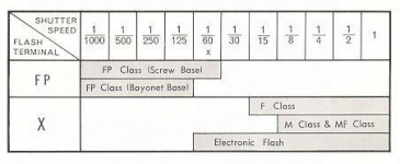

@freecom2 - Really showing my ignorance - I don't know. I will have to research which model but I suspect it is an earlier one and that it has a cold shoe as there are two connectors on the front of the body which I guess were for a flash cable connector
