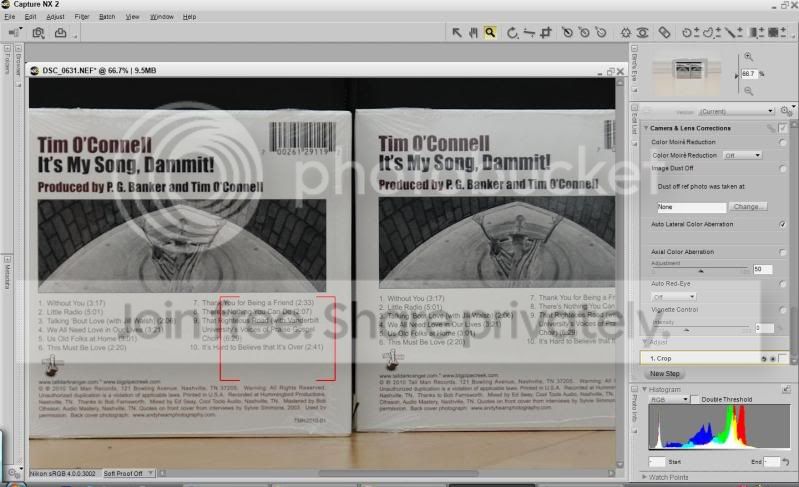

    Just got myself a Nikon D90 earlier this month and after a few trips out, producing pictures that were somehow less 'sharp' than I expected, I realised that I have a back-focus problem. What's more, it's with the camera and not with any of the 5 lenses that I've used with it - they all work fine on my D700 :shrug:.
    I know that there are tests out there on the Interweb, where you can print off test charts and measure the degree of back/front-focus, but I've drawn my conclusion from my own simple (but 'real world') tests.
    As an example, here are two shots of the same subject, using the same lens, but on two different cameras. The subject is a pair of identical CD covers, set up next to each other, but with the CD on the right hand side about 1" further away from the camera than the one of the left. Camera was about 8 feet from subject.
    In the first example, you can see (just about; the upload quality is not great, but it's easier to see on the larger versions in the links and impossible to miss on the RAW files) how the Nikon D700 has accurately focused on the selected focus point (these red brackets are from the RAW file and show the selected AF point).
    D700
    [​IMG]
    (N.B. I had the in-camera sharpening set to zero in the D700, so it's harder to tell the difference on these jpegs, but when you see the RAW files, it's clear).
    Larger ...
    However, using the same lens on my D90 and selecting an AF point on the nearest (left hand) CD cover, results in the AF point being slightly OOF and the sharpest area of focus is actually (in this case) 1" behind it, on the right hand CD cover. This is the same degree of back-focusing that I get on most of my captures from this camera/lens combination, at various focal lengths.
    D90
    [​IMG]
    Larger ...

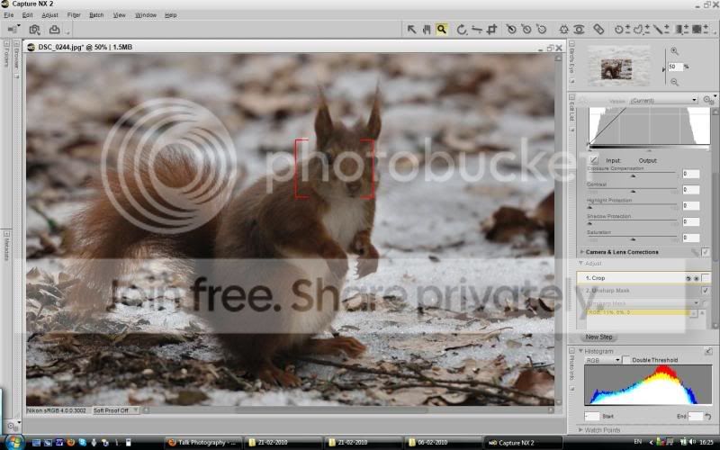

    Ah :shake:, well, 'pixel peeping' does come into it in my case, as I'm trying to do bird/wildlife photography in the winter months (when there's no decent light for anything else) and I specifically bought the D90 to use with a 200mm lens, in order to get more reach than my D700 could provide. I still end up having to crop the living daylights out of every capture, so when the camera focuses on a squirrel's tail, instead of his eyes ...
    [​IMG]
    (Look at that sharp area under his tail. That's not where I put the AF point, as you'll see below).
    Larger ...

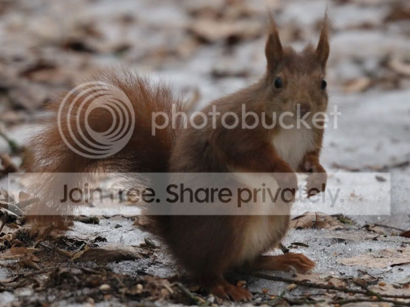

    [​IMG]
    This is actually a very good 'real world' example of why this is a big problem for me - I can't use a smaller aperture, as I need the shutter speed to be high enough to avoid having to use a high ISO. Evertything's against me for this kind of photography and seeing as I can't afford the proper tool for the job (a 400-500mm f/4 prime lens), I need everything to work properly.
    If the focus was actually on the AF point in the image above, it'd be a pretty fair capture - as it is, it's only fit for deletion :|.

    Regarding the OOF squirrel shot - this doesn't prove backfocus.
    Look at the area covered by your AF point - you've got the tip of the nose, and then the area behind where his front paw joins his chest - which point does the camera choose, given there are multiple bits it could go for?
    You probably do have a problem but you need to very careful when your AF point covers multiple possible lock-on targets. All Nikon camera manuals cover this scenario (examples where "AF may not work well") - always choose an AF target that is unambiguous.

    Wow, I'm really glad to see you've got your problem sorted out Naboo32. Out of interest, how would I go about seeing if I have the same problem with my D200? I've had a niggling feeling for months now that it can't just be bad luck that I'm having focus issues all the time. I sent my camera in to Nikon for a service not long ago and was hoping beyond all hope that it would come back and the AF would start nailing focus. I probably wasn't nearly specific enough.
    For the most part I've deleted all the "duff" shots but I think I may have a screenshot displaying the particular problem I have and have been having for a long time. I'm not saying for sure that it's the camera at fault but I would appreciate opinions. clicky

    Bit hard to tell - for starters if you wanted sharp eye, you'd been better selecting a different focus point - not sure what lens you have but its its an AF-S or HSM lens, you can just grab the focus ring to help out the D200s outer AF points (as they are not "cross" type).
    Can't tell anything for that really, but from the shot you've shown, my inclination is pilot error from the presented evidence.

    puddleduck, thanks very much for your reply. I'm inclined to agree with you looking at it now, that example does look like human error. The problem is that until I saw this thread I completely discounted the possibility of it being a problem with my body so I ended up deleting all of the shots I could use as examples.
    I was out shooting today and I've got an extremely boring Capture NX 2 crop that may show it better. Again it's nothing nearly as scientific as what Naboo32 has done. It looks to me like it's back focusing here but again I may be looking at this all wrong, please correct me if this is so.

    If your camera is backfocusing, that doesn't tally with your duck shot - a backfocusing camera would probably have got that eye in focus...
    Now the metal shot is a bit more compelling, but are you sure when you focused without focus and recompose. Remember Capture NX simply shoes the active focus point - if you focus and re-compose all bets are of..

    The second shot wasn't recomposed at all, the focus point shown in Capture NX was definitely the point of focus. The photograph of the duck can be ignored for the most part because it was so long ago I can't be sure where the point of focus was.
    I will give the cereal box method a go now and see where that takes me.
    *EDIT*
    Here are some full sized jpegs of my findings, they're saved at quality 9 in PhotoShop to keep filesize down. All were taken tripod mounted with shutter delay and a remote release, it was inside too so the cereal box was very stationary. Apologies for the terrible exposure. I had to redo the manual focus shot and the one after than because I goofed on the original MF shot, it was done under the same conditions, just later on in the day.
    70-200 AF-S at f/2.8
    AF from Infinity
    AF from Closest Focus
    Manual Focus
    AF After Manual Focus
    50mm AF-D at f/1.8
    AF from Infinity
    Manual Focus
