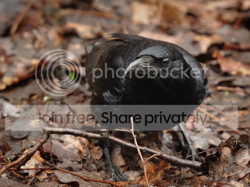

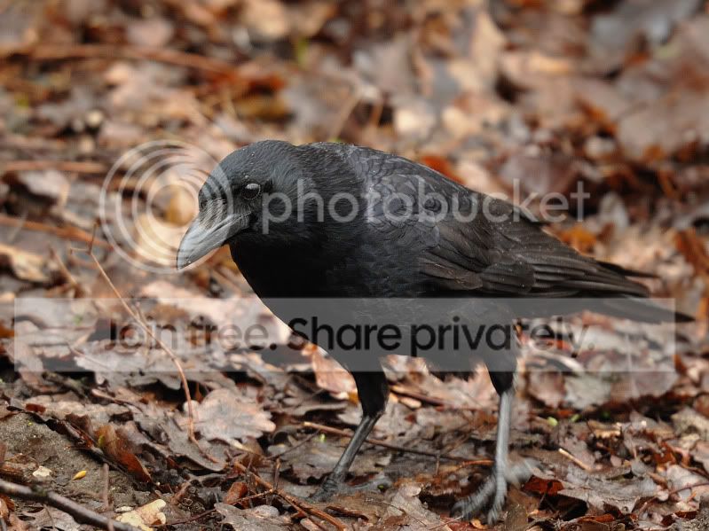

Not to 'rub it in' in any way, but just to illustrate something, here are some (fairly heavily cropped) shots, which I took at the weekend with my (cured) D90 and a Nikon lens at 200mm and f/2.8. The intended focal point was the eye of the crow, in each case ...
Not an easy subject for an AF system, I'm sure, what with being black on black and quite small in the (original) frame :shrug:. Still, I think that the AF performance in these shots (and other random test shots at different distances on the day) is just about as good as AF gets!? It's certainly a very different story to how these same kind of shots were coming out before it was serviced.
