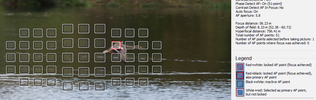

Mallard in Flight - distant RAW/NEF
Interesting data on the distant shot above - focus point is accurate and 56.23 metres away (Not locked because of focus point grouping and continuous although DoF is somewhat optimistic [beta software])
I am not sure that those "focus distance" figure on the "show focus points" plug in is accurate Barry
I know what you mean Bill - but for that shot I reckon 56 metres is not far off - it comes from the EXIF so blame Nikon for that one! I also wonder if it was where I first started tracking/trapped it - too many variable for a scientific, objective test.
The DoF calculation though is a plug-in algorithm I think. I reckon it's crunched the numbers against 200mm lens - certainly not 500mm! In fact, shallow DoF has been my biggest shock with this lens (after the invoice).
