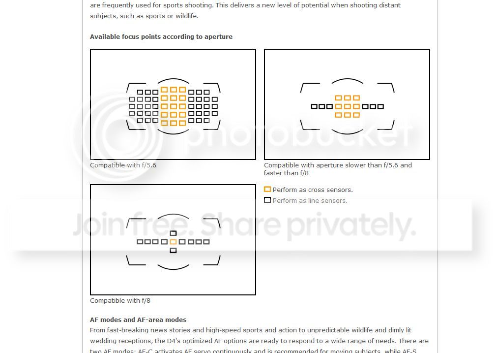

taken of the nikon site for the d4.
but its weird because my sigma 50-500mm os at 500mm is f6.3 and i have used the 51pt 3d tracking many time on the d300 and d700 and it seems to work no probs, despite what it says here about only 15 point being usable with f5.6 and slower lenses.
Nikon don't disable AF when the aperture gets too small, they just don't certify it as it's out of spec. Put a 2x TC on that lens and your camera will still try to focus, even if it keeps missing. Nikon saying it works now is them saying "you can use it and we stand by it performing as expected".
