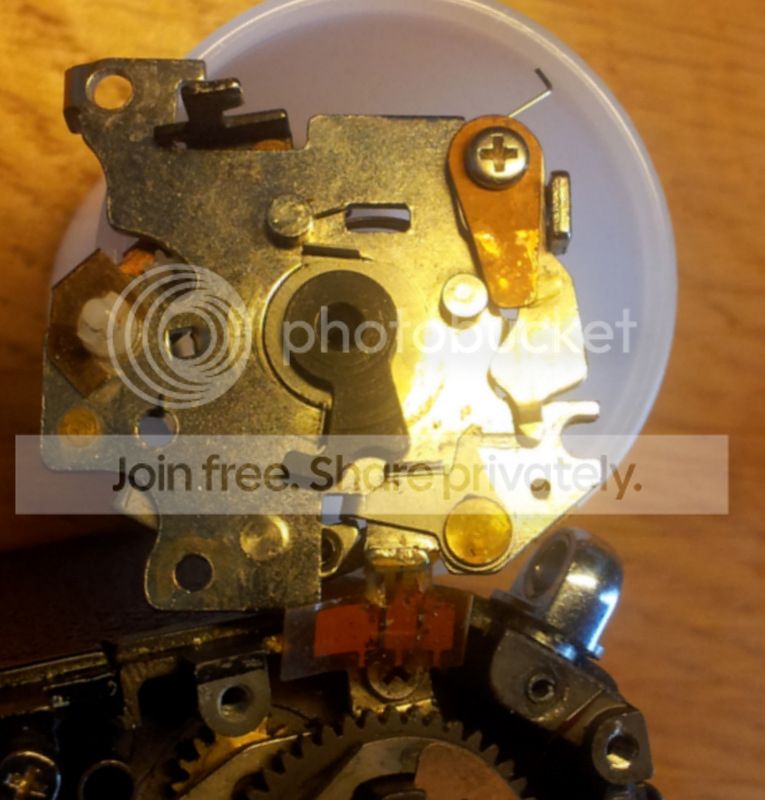

I may be able to suggest what is causing your winder fly back symptoms, as my FE exhibited the same behaviour. I was given a Nikon F301 and some lenses. I quite like the 301 but it seems a bit fragile and is noisy with the auto winder, so influenced by all the "tough as old boots" recommendations for the FE, I bought a cheap one described as "rough looking but functional" to use with the lenses.
Sure enough, it worked OK as long as I let the winder fly back quickly. If I let it return slowly by holding it with thumb pressure, then the meter didn't turn on and the shutter would fire but leave the mirror up. Turning to M90 would bring the mirror down again. Basically I had to wiggle the lever around the stand off position until I could see that the meter was activated to ensure a successful shot. After a few weeks of working like this, it died; the meter would never turn on and the shutter behaved as described above.
Newton Ellis wanted £110 to look at it which I certainly wasn't going to pay so I opened it up myself. This is the underside of the winder platform which shows the relevant parts:
The darker central piece is attached to the winder and rotates clockwise when winding on. To activate the meter, the tail of that piece is supposed to strike a plate at 90 degrees to the screen which is the slightly darker area of the shiny piece pivoting on the large brass rivet next to the strap lug. ( So in the photo it has turned passed the meter activation point) The large shiny piece then presses down on the other pivoted part you can see below it. That piece, which is on the other side of the platform, holds the wiper fingers which turn on the meter and presumably make the shutter work OK too.
What can't be seen, because it's edge on, is that little 90 degree piece has been worn so thin that it's actually split along half its length and been bent down by the black swinging arm. (I had straightened it out for the photo.) Thus when the black arm and tail pass, they don't contact to transfer the force to the wiper arm
I suppose it could be brazed back together again, but really it needs a new part. This is a very crude and poorly designed mechanism and I'm not surprised that Nikon abandoned the 'meter on in the stand off position' when they introduced the FE2. It shows that you shouldn't believe all the rubbish that is spouted about the indestructability of Nikons. They are good cameras but eventually wear out like anything mechanical and this bit is definitely a weak link (literally!)
I hope your trouble turns out to be something else but the symptoms are so similar I thought I'd post this. By all means try for the repair, just don't commit to spending too much money. Good luck.
