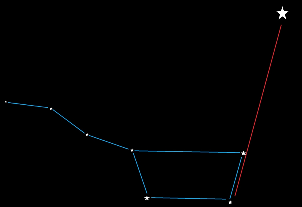

Oh and your Polaris finder isn't working, apologies if this has been mentioned before I skipped to the end of the thread:naughty:
Currently working on a new improved polaris finder developed/photography by Andrew (AndWhyNot) that should be sorted soon (y)
This is the old version :D
Polaris Finder by mwhcvt, on Flickr

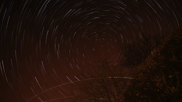

Just completed a 1hour stacked exposure, just in the back garden with no foreground, so I have a lot of trails but nothing else. But at least it's given me some idea of the process involved.
Great (y) I'm pleased it gone well for you I look forward to seeing an on location trail (y)
