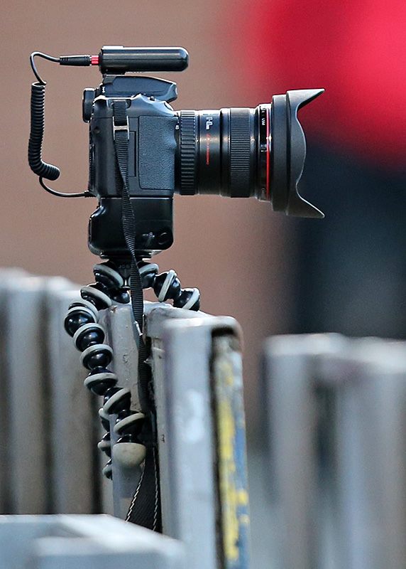

I am planning on putting a remote camera behind the goal line and I was wondering if anybody had recommendations for a tripod/support to hold the camera while on the ground, I have my normal tripod, but it does not go low enough for the look I am going for. Preferably I am looking for something that can take a full size body and a 16-35 or 24-70.

Can you invert the camera on the centre column and hang it underneath? Some tripods have this option. I see those gorilla pod things being used but I've never tried one.

Seen so many different ways of doing this. One of the neatest solutions - by an Action Images tog - was a metal circular base with a short column protruding through it with a ball head on the top. Small cheap tripod does the trick for me when I want to use a goal remote.

I had a behind the goal tripod it was great until it broke.. threw it away and didnt recall what model it was.... got a gorrila pod which worked but i didnt like as much... left that at a grround a few weeks ago.. (accidently i didnt dislike it that much haha) ..grimsby i think :( Now need another... but not in a rush.. rarely use behing goals camera at league two grounds because of the space..

Needs must sometimes.. This is at Bradford city at the old away end which was empty as away fans now in seats along sideline... wouldn't have used the wall if fans had been in there :)
