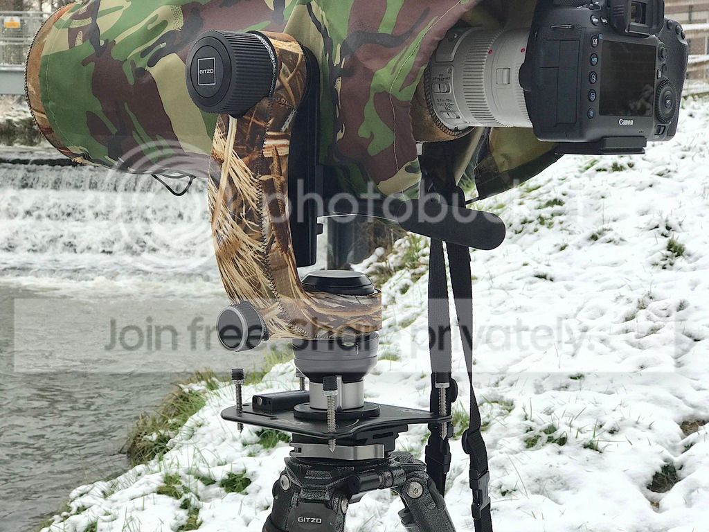

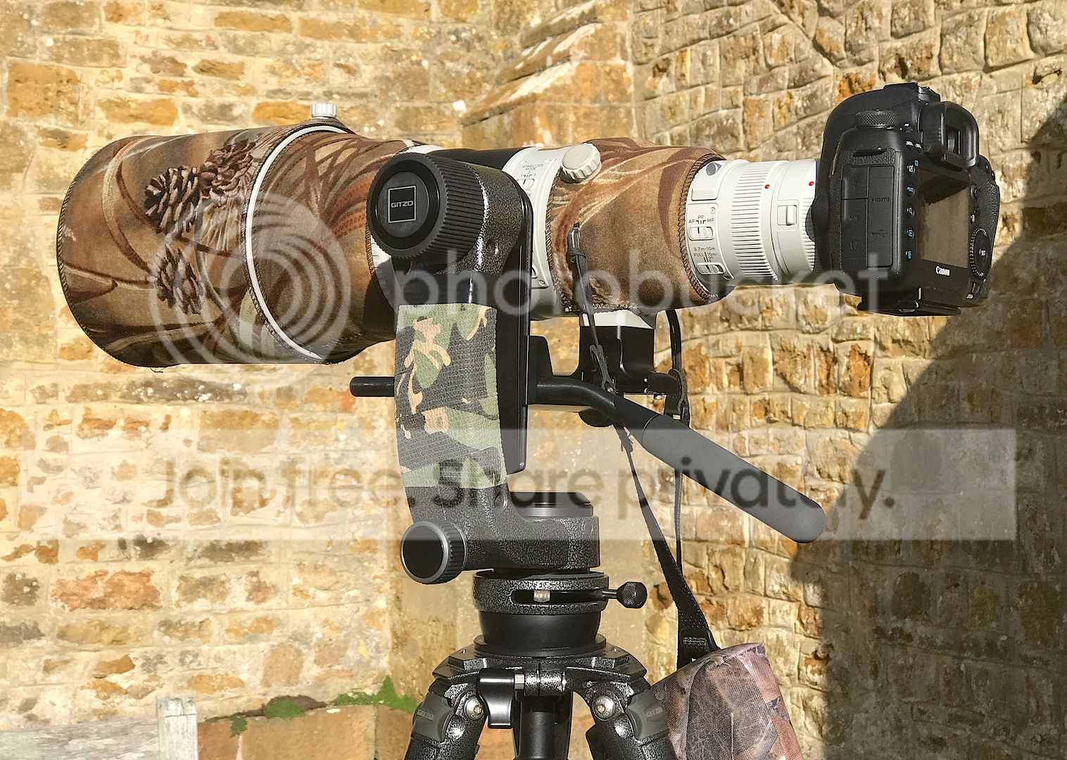

A snap of it on my iPhone :
The camouflage tape is only to reduce the cold feel of metal. LensCoat tell me that they will be offering a neoprene cover and also pouch after they receive their unit.
I prefer my mounting to have the gimbal column on the lefthand side, others prefer the righthand side. It is very easy to change the position and length of the panning bar while set up.
It does look bulky as Steven says and is 10 inches tall.

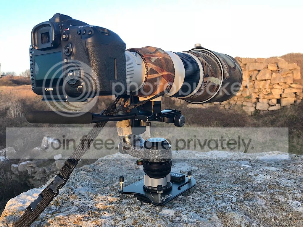

Having now shot about 1,200 images on it over the last couple of weeks I continue to be very impressed and it has definitely helped me nail a higher rate of sharp inflight photos. Its damping means I can now more comfortably use IS mode-3 (on my Canon 500mm F/4L II often with 1.4x) which automatically switches off all IS until the shutter is released - I shoot Back Button Focus. On other heads, switching IS off results in an uncomfortable 'wobbly' image in the viewfinder which interferes with both ease of tracking and composition - The longer the lens focal length the more this is exaggerated. The advantage of switching IS off via mode-3 is that the lens has to do less work internally and consequently can track and autofocus faster.
I am enjoying results from using this Gitzo Fluid Gimbal Head so much that I am now happier to lug it around on its tripod with levelling base.
Gaz, which other gimbal do you prefer your new Gitzo to please?
^ An example shot @ 700mm on Canon 5D4 on Gitzo Fluid Gimbal

Have to ask though @RedRobin what on earth do you have between the tripod and the head?!
....A set up which allows me to quickly remove everything above the tripod legs and then shoot at very low level or shoot from a rock or somewhere a tripod can't be used. Consequently I can be on a 'walkabout' and have increased position flexibility according to the wildlife subjects I encounter.
It consists of a RRS long QR lever clamp attached to my Gitzo Systematic 3 tripod. The broad and long Arca profile plate from my Gitzo Fluid Gimbal Head is attached to the underside of a PlatyPod Max platform onto which is fitted a RRS Levelling Base under the Gitzo Fluid Gimbal Head.
It also works well on the shelves in hides.
The balance is fine and is more stable than it looks.
EDIT :
I have now found that if you need to be in a hurry to grab the photo opportunity it can cause delay while adjusting the screw legs. But otherwise, no problem.
