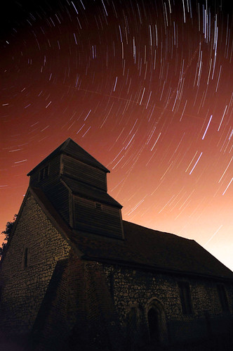

From memory this image was a stack of 40 images of 30 seconds each. There is quite a large town just a couple of miles away in the direction that the shot was taken, but by keeping the exposure relatively short, the resultant light pollution wasn't a problem.

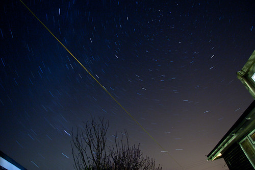

Star trails and Perseid meteor "shower", 2007
Detailed notes on how I did it, and the general DOs and DON'Ts I picked up by trial and error, here.

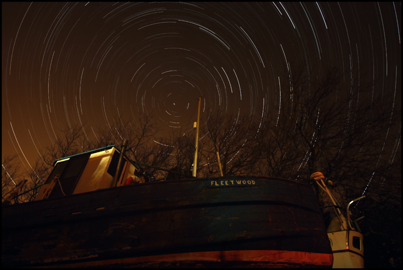

Single exposure (exif on flickr page). Check out the celestial equator where the stars appear to change direction.
Stacked exposure - 40mins worth. I've just had an A2 canvas of this made for my exhib- looks awesome :thumbs:

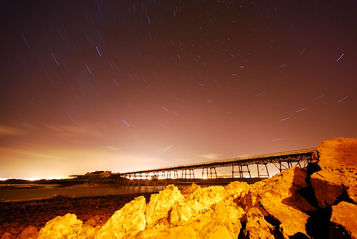

To the OP - this is only just down the road from you - Birnbeck Pier on the northern outskirts of Weston. Single exposure (exif on flickr page)
Amp, should've said earlier but that lighthouse image of yours is spectacular
Thanks. :)

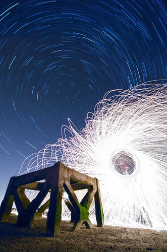

Those images of yours are stunning as well (especially no. 2! Did you use light painting?).

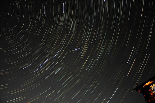

Here's one I did after trying to get some of the Perseid meteor shower... That's not a meteor in the middle, but rather an Iridium flare.
