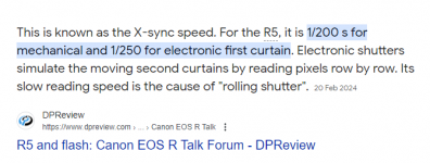

above posts have disapeared it seems but to confirm, sync speed on first curtain is 1/250 as the flash doesn't work in electronic
I tried to look at you shutter setting in one of the above shots. Get out of EFC and use M only for flash.
The R5 shutter clears incredibly slowly (1/60th) and that can cause significant issues.
