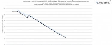

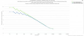

So from this then I assume the A7V will take a big hit in DR using the ES?As I mentioned in one of my previous posts, canon drops the bit rate and/or dynamic range in favour of FPS and fast readout.
Basically with normal sensor you cannot readout all the data quick enough to avoid rolling shutter and shoot at higher frame rate, so they just read less of it
This is less of an issue with a stacked sensor in R5ii but on a non-stacked sensor like R6II or original R5 its massive hit to IQ.
I would like to see the results on R6iii when its up but I feel it'll be more like R6ii, may be slightly better but probably not much more if its not even partially stacked.

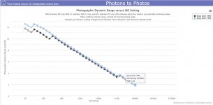

Just had a quick look at the video you are referring to, Tony is purely talking about video DR and not stills which I guess is where some of the confusion is. Sony don't mention DR in video AFAIK.Also just watched Tony’s video review, he seems convinced that the DR claim is a lie and is infact worse than the IV .. which he expected as all these partially stacked sensors seem to loose DR not improve.

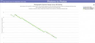

A7V DR tests are out, seems Sony's claims are correct. I would trust these over the Northrups any day of the week. It seems it doesn't have the dual gain of the A7IV though.
I don't know which camera has the highest DR, unfortunately there's hardly any cameras that have been tested with ES. I think there's only 1 Sony, the A6700, and 3 or 4 Canon. I think there's 1 or 2 Olympus as well. I'm not sure why they don't do both for every cameraLooks amazing! I guess that would mean this has the highest dynamic range on the market?
But petapixel also mentioned there is dual gain in ES mode. No charts (yet) for ES![]()
Was just about to post this and the dp thread where the guy that does this postedLooks amazing! I guess that would mean this has the highest dynamic range on the market?
Rumours guys thinks it is.....I don't know which camera has the highest DR,

for some camera like the R5, R6ii etc they do have it. even for the A9 for example. with A1 i don't think there is much difference hence he doesn't bother. And sometimes he just have the data perhaps.unfortunately there's hardly any cameras that have been tested with ES. I think there's only 1 Sony, the A6700, and 3 or 4 Canon. I think there's 1 or 2 Olympus as well. I'm not sure why they don't do both for every camera![]()
yeah they are supposed using some kind of "AI NR". Canon have been doing this since R5/6. they use that technique to match Sony's DR, now Sony with similar method might have gotten a bigger boost.Was just about to post this and the dp thread where the guy that does this posted
Yeah seems that the didn’t lie regarding DR but they have also applied NR baked into the raw files
