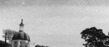

Will they show up on a print and if so how do you get rid of them?
1 - Probably yes
2 - Depends what they are
- Dust - clean it off with a microfiber cloth
- Water marks - try rewashing with photoflo, or gently dab off with a microfiber cloth
- Scratches - Can't be removed
- Blemishes in the emulsion - Can't be removed
I am assuming white spots as in precipitated developer or fixer stuck to the emulsion which will show as white spots on the print, have you tried a prolonged re washing?
When my Xtol stock was getting old the resulting negatives looked like they had dandruff. :(
I usually get the odd one or two when I have scanned a shot, but some films seem to throw up a few more, no else seems to get them so I am thinking that I must be doing something wrong.
I have not tried to look closely at the negatives, I don't have a light box to check them,
What is precipitated developer please?
I have not tried any further "treatment" after viewing them on the scanner just thought "oh thats s***e" and left them . But I have a couple I really would like to print eventually but whats the point if they have dots everywhere.

Can they be removed in the printing stage Rob ifs the odd one or two?
In the old days, people spotted prints using retouching dyes; if black marks, after removing the black spot, if white "as is". Dyes are still available as inkjet paper can suffer from dust specks just like negatives (and printing paper).
For identification of the type of mark hold the negative obliquely and scan the surface with a lens.
I need to find the cause

Which film was it, Wayne?
Some faulty batches of Fomapan have had issues with white speckles on the developed negatives. I've been caught by those on more than one occasion, and you'd need the patience of a saint to spot them all from a scan or a print (although I have seen suggestions that a wash in an IPA solution can remove them).
I've had occasional white spots with several different film stocks, although most frequently with Fomapan.
As suggested above, it is worth trying a re-wash with a wetting agent.
It may also be worthwhile using distilled water for developing, if you have impurities in your water supply. I generally use distilled water for the final rinse (with wetting agent) and sometimes use it for mixing the developer and fixer too.

Hello Nigel
I get the occasional one or two in many films, the worst offender for me has been type 517 where there have been hundreds in some images, I have gone through the whole gamut of considerations from a batch that has failed QC that is why it was not used, too Its all my fault.
I need to pin down exactly whats going on, I will clean out my dark bag and start from there see if that has dust in it or something, I will then look at my chemistry, but even If I develop two rolls in the same tank they are different regards the spotting
How big are these spots, what do they look like. Do they appear to be on the surface. Are they transparent or or solid white.
The most common causes are either hard water or undissolved developer or fixer,
The cure is the same rewashing in filtered water.

Those aren't white spots on the negatives, you are showing a positive.

Thanks to the advice I have kindly received from the members on here, I have also discovered that I under developed the film by about 6 minutes - I used the old development times.

You've probably already told us, but I'm an old man with a failing memory. How do you dry your films, as in my experience that's where most dust comes from. Have you examined the negatives to see what the spots are? Are they on the emulsion side? Have you used a lens - I'm bring deliberately vague again, as a camera lens can be used as a magnyfing glass.
To be honest Stephen I have not had time to conduct any inspections as a bit busy at the moment, I have penciled it in for the weekend. I dry my films in the bathroom, but the kids are in and out running my gas bill up taking showers etc wafting and slamming doors, it must be like a dust cyclone.
I will get a sheet of ply and make a drying cabinet at the weekend.
