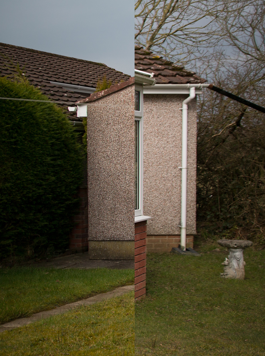

Well,after much anticipation I received my new lens earlier in the week.When I get a new lens I normally just walk outside a take a few images and have a look on the back screen and if it looks ok that's good enough for me.I did the same as usual with the new 24-70 but something didn't look quite right with the images.I put it down to poor lighting,handholding without the help of IS etc.
However, I decided to test the lens properly this morning just to make sure.I'm glad I did because I found the right hand side of the images to be very poorTotally gutted and the lens is now on it's way back to HDEW for a refund.
It's the first time I have had a duffer and it leaves a bit of a horrible taste in the mouth,especially on such an expensive piece of glass.I'm now stuck in the dilema of trying another one or just going back to a trusty old 24-105L.I was sucked in by all the reports of sharpness across the frame at F2.8.
There seems to be more and more reports coming from people with less than positive experiences with this new lens.
24mm F2.8-manual focus using live view and full mag.Both ends of the bungalow are the same distance from the camera(approx 35feet).
Crop each side
Things don't get a great deal better at F5.6

Lens misalignment - it happens. Personally I might have been tempted to get it calibrated to the body under warranty, but I can understand returning it.

When I look at that top picture, the two sides of the bungalow don't actually look equi-distant to me, and I can't really tell because of the summer house. Are you sure they are? Sorry if I'm asking a silly question!

That's not just a 'poor copy' it's clearly faulty and would never have got through anybody's quality control like that. It must have suffered a misfortune somewhere along the way.
