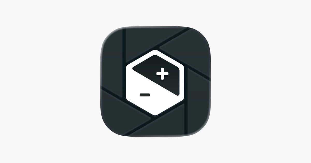

I have an Sp1000 also with a 55mm Takumar lens. What app are you using for the camera? My Huawei doesn't do aperture in Pro mode but I can do ISO and shutter! Go figure!
This is the app. It's on the Apple store, but once you know what the icon looks like I guess you can search for it on your store... Free, but I paid the pound to remove ads.
