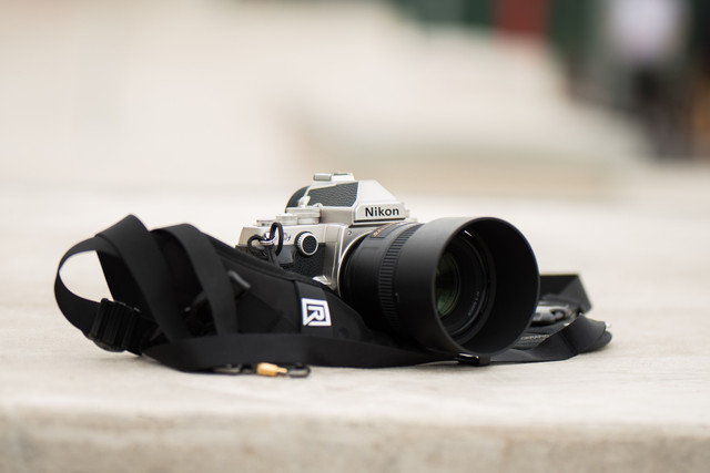

Oh, and my wife bought her Df along too.
