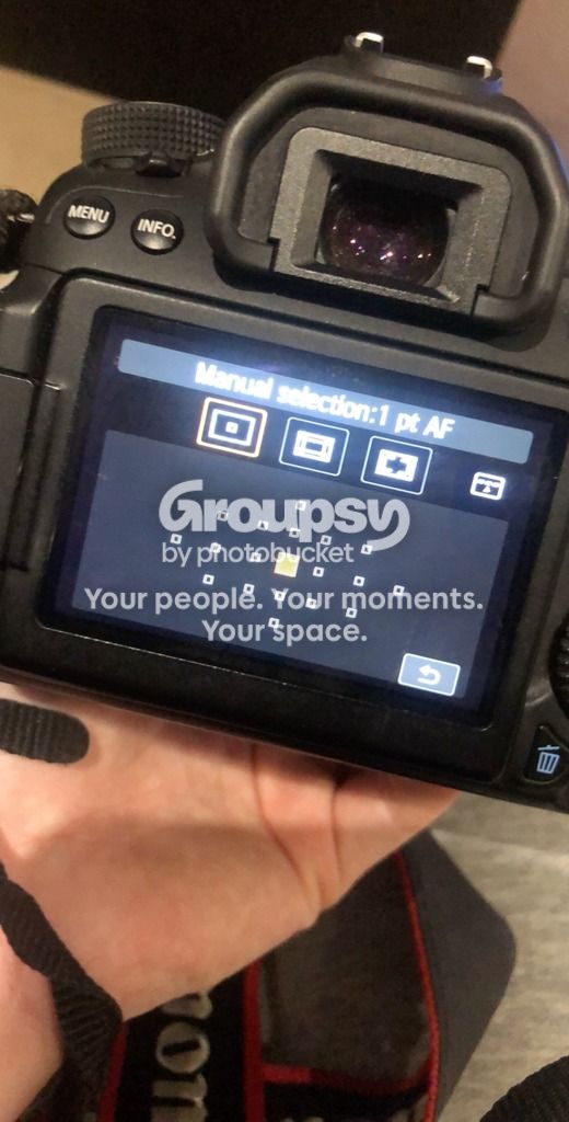

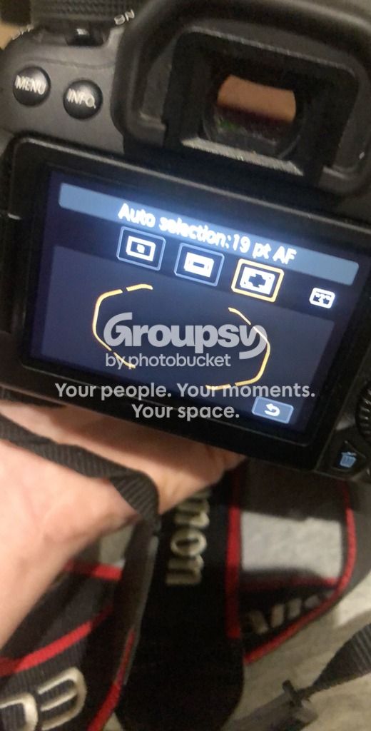

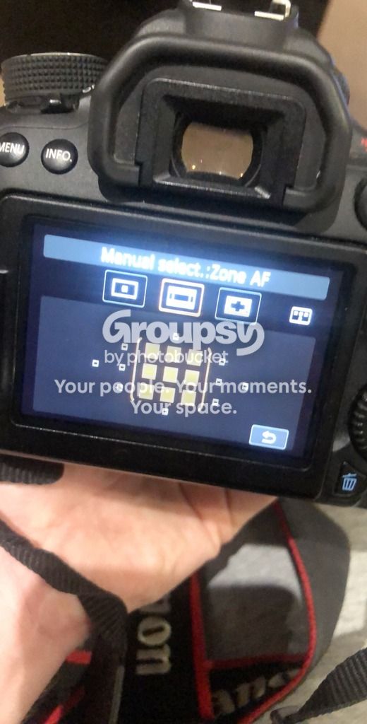

@willkia are you aware as Steven illustrates that you can select any single focus point of the 19 showing in your first "back of camera" image......do you have the camera manual to tell you how to fully control what the camera will focus on???
Having you actually tried any self structured tests.....(as I recall suggesting in your other very similar thread)......even perhaps a 45 degree row of batteries to experiment with focus point choices and how aperture will control DoF and yield more "subjects" in focus???

6,908
#19
Yeah I want them both in focus and a nice blurred background. I just wasn’t sure if it mattered if the focus point was on one of the lad rather than the other
In broad terms no! it is the DoF that is important as explained in various replies above and on the other thread.
Perhaps this might help clue you in as well take you through the steps to calculate the aperture you should select http://www.dofmaster.com/dofjs.html
But, as in the case you posted of two (or more) subjects separated by either lateral distance or longitudinal distance you really need to choose the focus point and not the camera choices of centre, zone, all points. As Steve @sk66 illustrated you should use a single point but not the centre one. I hope that makes sense.
