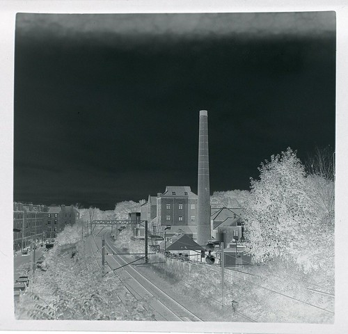

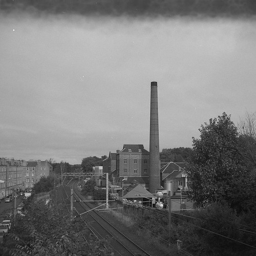

That would be a little disappointing but I'm hoping its unlikely as I've only just got a roll of slide film back from it and there was no sign of an issue. I suppose it could be some Chinese quality control from the GP3 or just not quite on the roll correctly.
Initially I suspected an encroachment on the film plane, but on looking again the mottling would appear to suggest a chemical problem. This could be due to a lack of developer in the tank across the top of the film, which then when you have fixed leaves a blank area which then prints or scans as a black mottled area. I would be interested in seeing a scan of the full negative including rebates.
One full negative, easier said than done with Gp3 curls enough to hold the lid of the scanner open. Developer was Rodinal at 1:50 so nothing exotic and I made about 600ml and the tank suggests only 520ml for 120.
Light leaking would give white band/streaks/loss of contrast would it not?
Once the mention of chemicals was made I thought that it that was most likely right and it was an issue with chemicals not getting to the neg evenly. I've been lucky and not seen many faulty negs.
Well I'm glad this came up on test roll and not any thing interesting. What would cause this do you think? Poor agitation technique, insufficient chemicals?
It could be either of those, it could also be contamination from previous use it could also be an issue with the film (storage perhaps if used from cold condensation), if the tank was immersed in a shallow water bath and the temperature changed dramatically then this could also be a cause. To aid your investigation, you should try to work out where this band would be on the film in the spiral as you process it, most cameras would have the sky at the bottom

What I was trying to say was that some cameras have a strange film path and that the film may not be orientated on the spiral with the sky at the bottom as is normally the case, or did you invert the spiral on the centre column prior to loading into the tank.
Whilst unlikely that the film path is different it needs to be checked as if a normal film path then that is one less issue to look at, if you can remember whether you loaded the spiral onto the centre tube as is or did you invert it as if not, this could immediately knock out the issue of insufficient chemicals as the band would be at the bottom of the spiral in the bottom of the tank, this could also then support a temperature issue if tank was placed in a shallow water bath.
Cheers Ed, I've no way to work out if it was the top or bottom of the spiral that was effected as I'm not all that disciplined getting it on in the dark bag so it probably got turned round a number of times before it ended up in the tank.
I'll do as you recommend shoot a good roll and clean the tank thoroughly. Hopefully I'll just never know why it happened...
