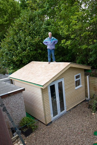

My Dad has just built me something similar that I designed for my backgarden. It is more of an office for processing my work rather than a studio but one thing I did with the spec was to include for a wooden shingle roof instead of felt. I would consider this as the felt won't last, it'll crack in the sun during the weathering process and then leak, the shingle roof looks great and everyone who has seen the office has commented on the roof. I have attached a picture below.
The picture was taken the day the roof was finished, it looks better now it has got some lights on the outside and we've got a few pots and stuff around it!
I would also agree with everyone else in voicing my concern on the roof structure, it looks very poor to me in terms of strength!
