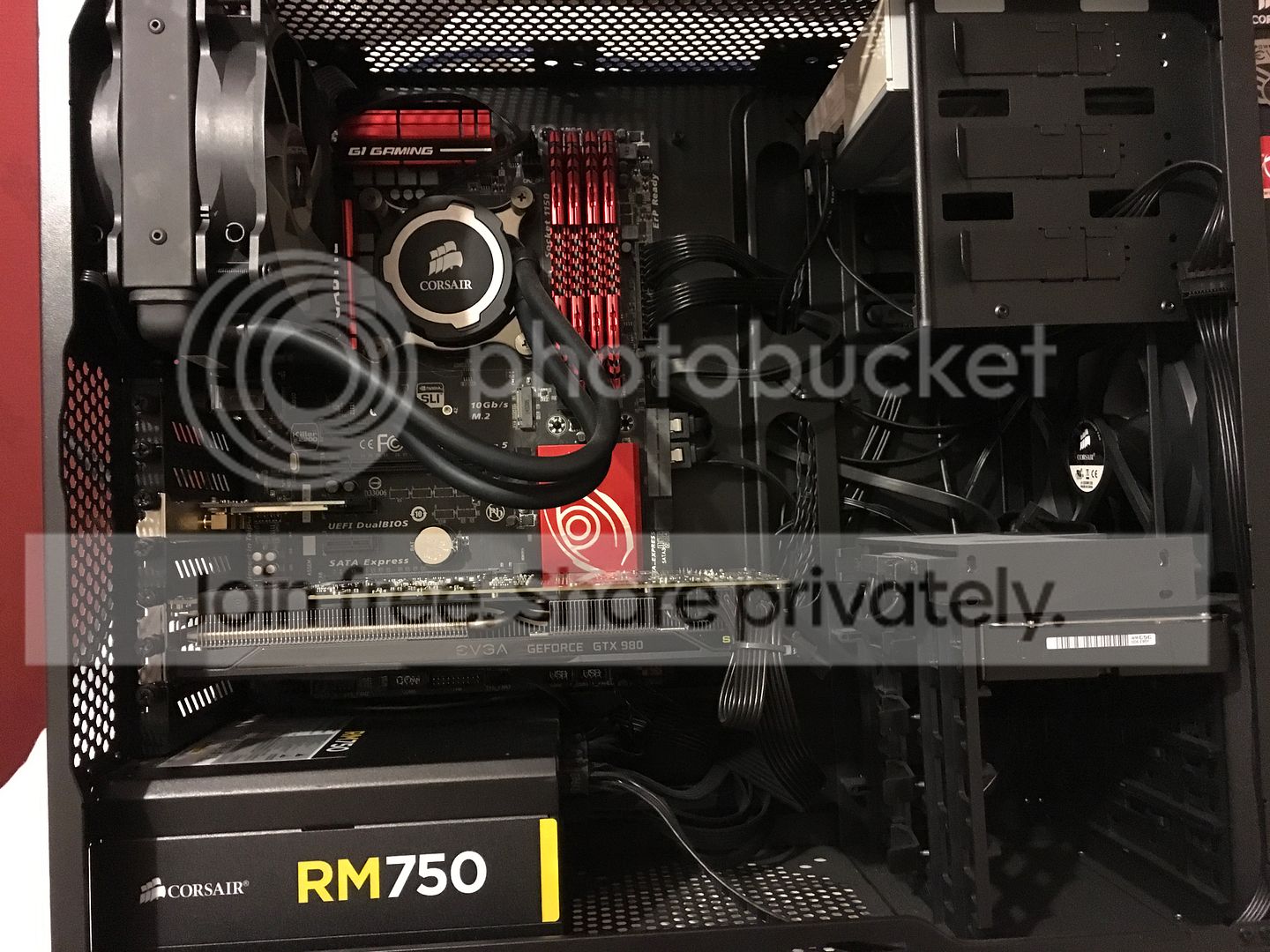

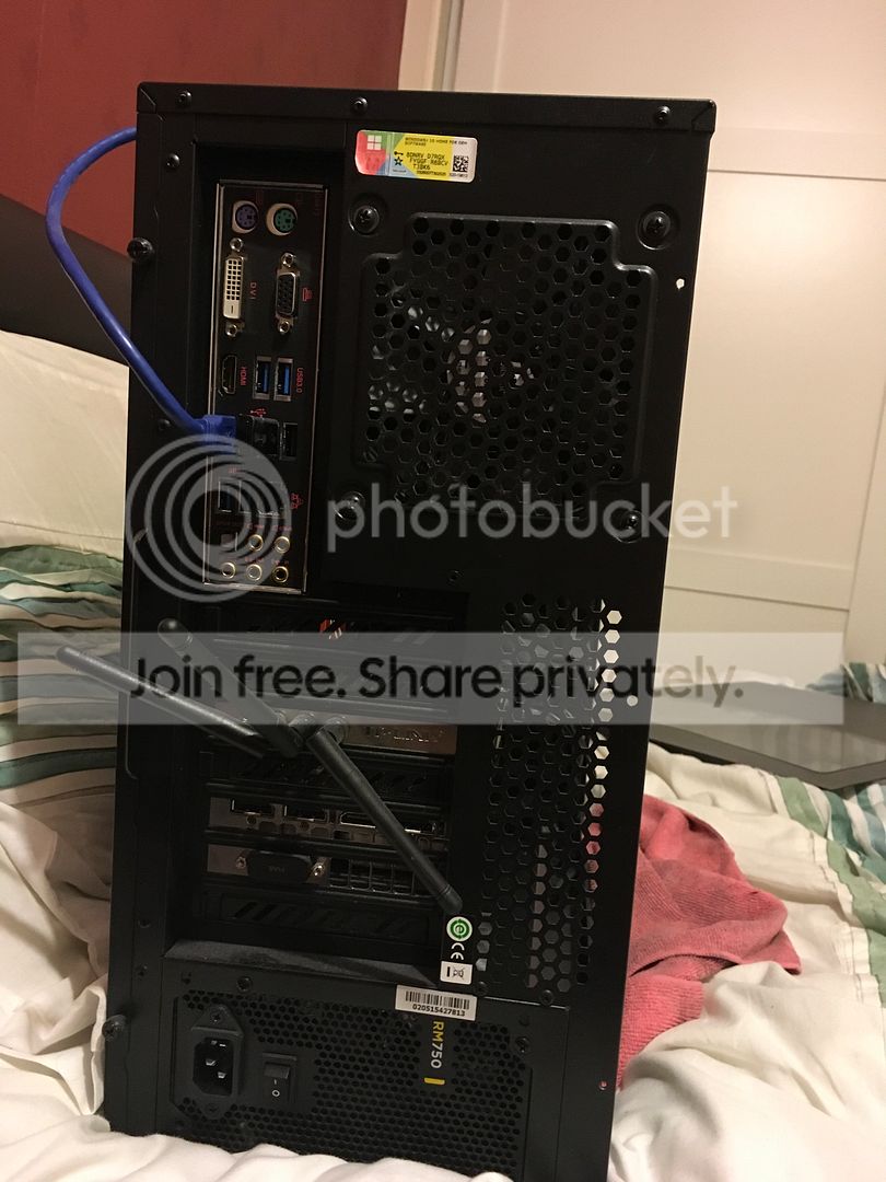

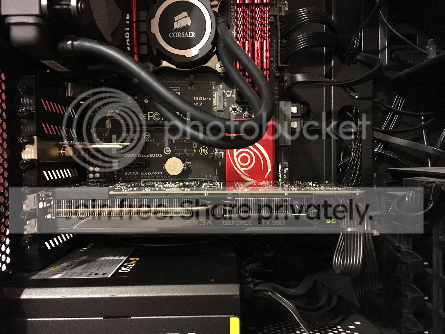

Ok, here are some pics. Hope that helps as I’m confused. I’ve open the case but no idea what I’m doing...
Right, the last picture shows that the motherboard has on-board DVI and HDMI, they are both labeled in red print. This means you should be able to plug your screen into that onboard HDMI
You may find just plugging in the screen will mean on bootup it will 'find' the screen and bypass the installed graphics card and get you up and running!

Im pretty sure you cant have on board graphics and a seperate graphics enabled together so the onboard might not work as long as the BIOS is recognising the GTX 980 as the main GPU.
Unplug the graphics card from the motherboard (this might force the bios to default to onboard)
Then try the HDMI cable from the motherboard I/O and see if that works
If not then i would try and boot into the PCs BIOS and see if you can see what it is showing for the dispay adaptor
