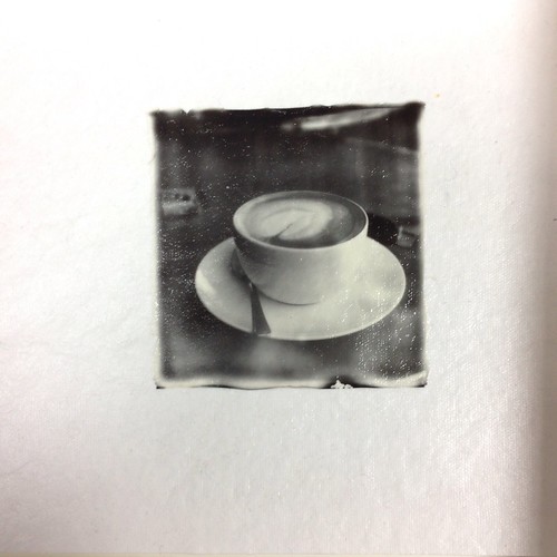

Just had a go at my first emulsion lift today. Pleased with the results...
Interesting effect, details please.
How, why, where, what & who etc.
I did it like that, but not quite the same ;-)
I use a knife to slice the chemical pods off the bottom, then run a blade flat around the back though the white tape that seals over the black background, then just peel off the black backing.
I used three trays, two with hot water (60 deg C) and one of cold.
Go into the first tray and lightly use a paintbrush to remove the white chemical residue from the back of the print (takes seconds) - this leaves white speckles in the water, hence my transferring to another tray for the 'lift' (as per instructions above) mine took about 2mins to start to float off - you'll need to work round the edges with a no2 brush to free off the edges
Then use the paint brush handle to pick up the very gelatinous image and drop it into the cold tray. Tease it out to full size then slide wetted paper under it. Position the image where you want it, and remove the paper from the water.
Dry them flat & job done.
It's a very simple process that sounds really complex here - it's not.
It's 'fiddly' rather than 'difficult' - I have 'fists of ham' and managed it ok!
Nice results and it suits well the picture, i've only tried this with a pretty rubbish shot before. How did you get the picture to glue to the paper? I remember mine did tried out and then fell of the paper! That makes me want to try again!
If you do the lift using warm water, and then slide it onto the watercolour paper in the water, you won't need any glue, as it dries it'll stick to the paper...
