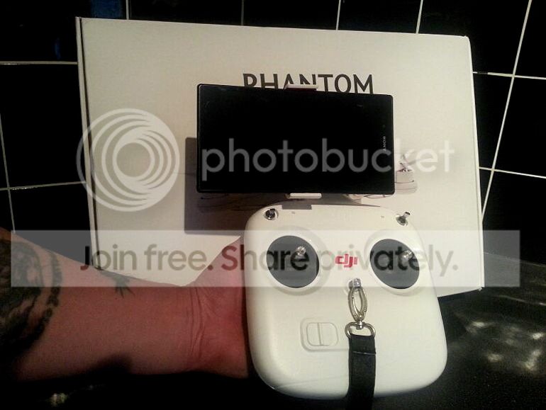

Go for it..this will give you fpv through the dji app for android or ios phones. Comes with nice clamp to attach your phone to controller.
So to use one of those nice monitors I've seen you'd need a different controller?

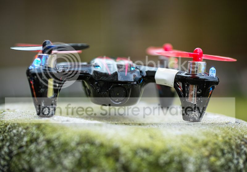

chris just a thought have you checked the legs?..they are designed to "fracture" if you crash and just need a firm press to click back in place.I took off a few times when I first got mine and wondered why it was all over the place then one day noticed the legs were fractured,clicked them back in place and it was fine again.Heres a pic of mine..bit war torn as the dog chewed on most of it!You can see the right leg at the front has tape ariund where it fractures..the one on the left is how it looks fractured without tape.I ended up taping all 4 eventually as they click out of place too easily imo.

Thanks for the input everyone. It would appear I've got a damaged motor, it doesn't spin up until i'm on full throttle. I guess that would explain the erratic pulling to one side. At least the parts are relatively cheap.
