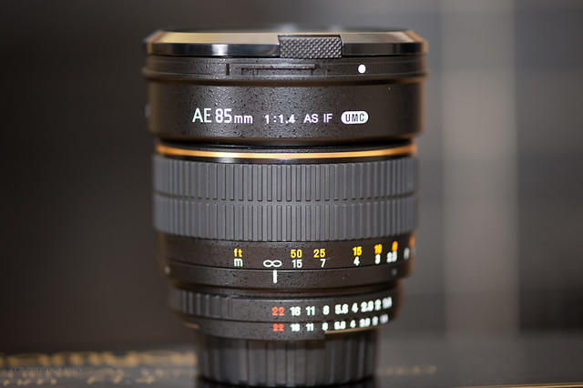

Guess what just arrived!
Pictures and mini review coming soon...
