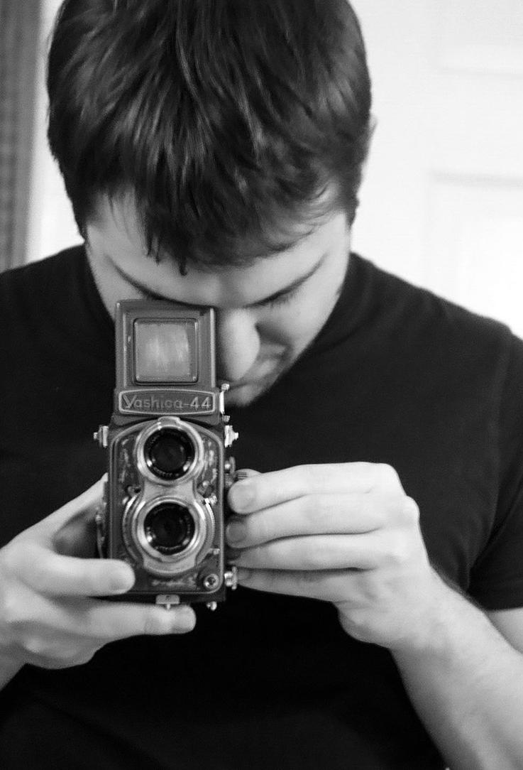

I'm really intrigued by these little 127 TLR's and I think I want one, I mean who wouldn't want a TLR so small you can fit it in your ear...or pocket (I suppose that makes more sense). I've been looking into 127 film and there seems to be some confusion over whether it is in production/about to go into production/dead as a-line flares with pockets in the knees.
Can any of you worthy F&C'ers shed any light on the availability of 127 film?

you can fit a 35mm roll in them, ofcourse you get a rather tall cropped view, and you should probably just use 24exposure as it get tight feeling towards the end
does need to be unloaded and rewound in a dark bag though

You don't need to have original 127 backing papaer.
A little patience and some "Blue Peter" creativity ( we all recall how creative they where on that program don't we?! lol) means you can use 120 backing paper.
Simply cut to length and width,
"Dry run it on spools through the camera and calulate the frame sizes and thus note the frame numbers in biro on the paper.
A bit of tape, (masking or gaffa works best as it can be peeled back easier than cellotape on the paper) to hold the film in place.
Spool 35mm onto the 127 spool.
Load into camera ( best done in the changing bag / dark room as the film is likely to spring off the 127 spool.)
Yes a little bit faffy but perfectly feasible if you really want to get use out of a camera of which as limited film availabilty.
As Paul says, you end up with a cropped shot which has to be taken into account when composing in the viewfinder but hey, a camera brought back to life!
you just need to remove the bits in the top that tension the 127 film, with them removed the 35mm canistor fits, but is abit loose, i use a couple of coins to get it tight and not offset much (1mm or so from centered),
you will have spacing issues, so i wind so it says 12 on the counter, then tape the leader to the 127 take up spool. then each time you shoot wind on twice. you get spaced out pictures but saves them from overlap.
