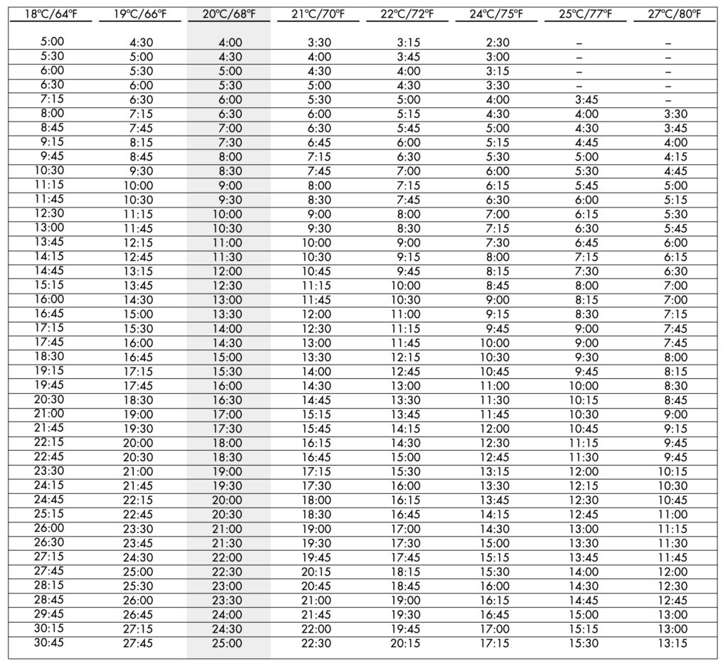

You don't need to go down the whole route for the zone system to be useful.
The concept of meters being calibrated (more or less) on an 18% grey (zone V, see table below), and visualising what that looks like, can be very useful for "pegging" the best exposure and getting a feeling for where other tones might "fall".
For example, If you look at the table below, it shows that if you take a meter reading from a grey card (Zone V, 18% grey) being held by a person with Caucasian skin, and make a print where the grey card in the print matches the "actual" card, then the Caucasian skin will appear in the print as one stop lighter than the grey card: which is the tone that looks about right for this skin tone.
Equally, if you take a meter reading from Caucasian skin, the meter will assume you want the skin tone to match an 18% grey, and if you follow the exposure given by the meter you will underexpose the film by one stop.
But as a Caucasian skin tone might be more readily available than a grey card, it can be useful to take a reading from a Caucasian skin tone, and give one stop more exposure than the meter says. This "places" the skin tone on zone VI, and allows all the other tones in the picture to "fall" into zones centred around the zone you have determined as being the most important.
Once you have determined your exposure based on the skin tone, you can then measure the light being reflected from other "important" tones within the picture and see where they are likely to "fall".
You can do this by knowing there is approximately a stop of exposure between zones, and if an important shadow area falls into an unacceptably dark zone, you know that you probably need to add a bit of lighting into the shadow area, or increase the exposure knowing it's going to overexpose the skin tones. This might just mean using a softer paper for printing, or it might mean you blow some important highlights.
This is less of an issue with black and white film than it is with digital, but it can also suggest where a small reduction or increase in development might be useful to keep detail across important tonal areas.
Simply "thinking" in terms of zones isn't a foolproof approach, but it gives a framework to help structure (and discuss) how you decide upon the "best" exposure.
