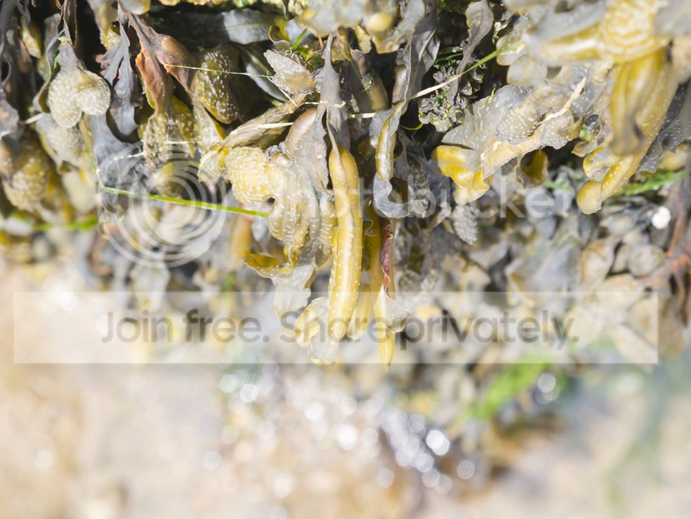

At certain shutter speeds and with certain body and lens combinations you get camera/lens induced motion blur. What this means in real world shooting is you get slightly blurry results which if you look closely display the blurring or a slight double image. I've found that when viewing a whole image it can be difficult to see what's going on beyond the shot looking unsharp and generally naff but on close viewing it's easy to see what's going on.
This guy posted some good examples...
http://www.cavecom.com/screwdriver/forum/showthread.php?t=21372
I was using a G1 and never came across this issue. I then bought a GX7 and used it mostly with primes and again I never saw the issue. I then bought a G7 which came with a 14-42mm lens and I mounted the lens on my GX7 and used it on a day out and when I viewed the pictures I was disappointed but I put it down to the lens being a cheap and nasty piece of tat but when I used it on my G1 I found that it was in fact quite a good lens so I looked into what was going on and found that both my GX7 and G7 were badly affected by shutter shock between shutter speeds of something lower than 1/100 to something under 1/300. The work around is to not use these shutter speeds or to use the electronic shutter and the electronic shutter does cure the shutter shock issue but unfortunately can create issues when shooting fast moving subjects or when shooting under flickering lighting. I don't tend to shoot fast moving subjects but the flickering lighting issue is a problem for me and IMO the affected camera and lens combinations are effectively unusable in some conditions, such as under flickering lighting.
