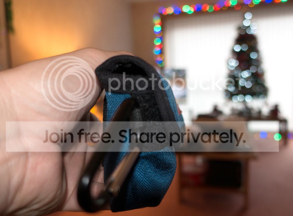

If it is of interest to any RX100 owners, I asked Santa for a case to protect my MkIV, this is it. Its called the Manhattan Portage Small Camera Case and costs about £23. It has a carabiner and a belt loop. It is secured shut with velcro.
