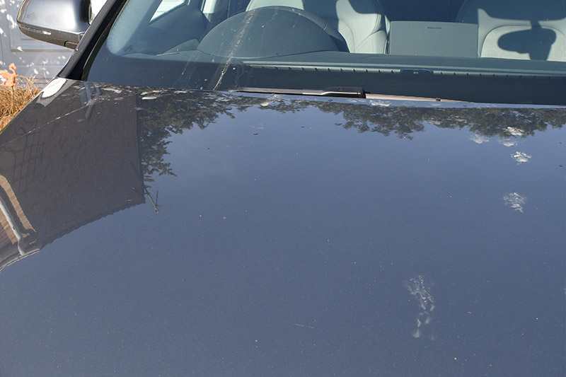

So which of our local little furry things was this? I have a short list of suspects....
No particular artistic merit, just an excuse to use the X30.

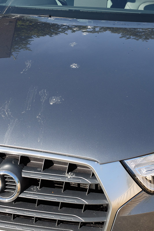

Still a nice clean sharp photo (shame about the car) I think the birds thought it was a VW and were getting their own back for years of damaging the environment and lying about it
Nothing avian about those splodges, John. Those are muddy feline paw prints. And it is a VW, sort of. It even has the same number in its name as the sole (so far) implicated Audi.
