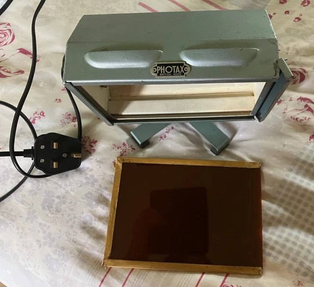

On bulbs...
My safelight uses 25W bulbs. I knew that they would soon become unavailable by decree, so when my local hardware shop finally closed (uneconomic rent) and sold off their remaining stock cheap, I bought all the 25W bulbs they had.
On bulbs...
I will check my safelight, didnt think of that. Thanks
Amazing what a second or 2 on Google can throw up!
Or you could source a Small Edison Screw lamp holder and use oven bulbs which will be available for a reasonably long time, I reckon.
FFS
I have been trapesing round the shops.
Thanks for the link and good Idea !
Modern safelights tend to be LCD or something like that. My Photax safelight (30/- in 1960) is rather before their time. The continued value to me is that it takes slide in glass filters, (7/- in 1960) and I've acquired a few more over the years including an ortho one.
Whats that in todays money ?
30/- is £1.50; 7/- is 35p. Fillet steak in 1968 was 12/6 lb which is 62.5p. Waitrose price for 1 pound is £37.50. Waitrose was the first search engine result. Milk was 4p a pint in those days. A Nikon F was about £157 and a Hasselblad about £250. Camera prices not checked, just from memory.
