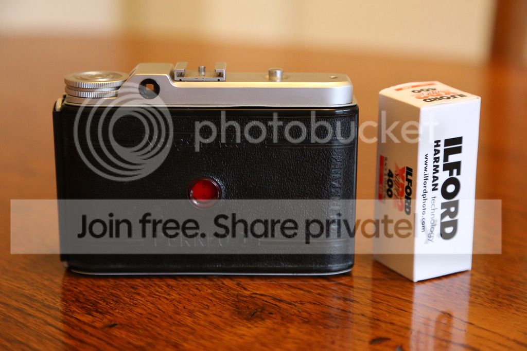

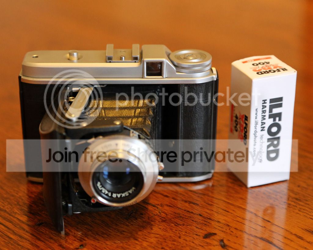

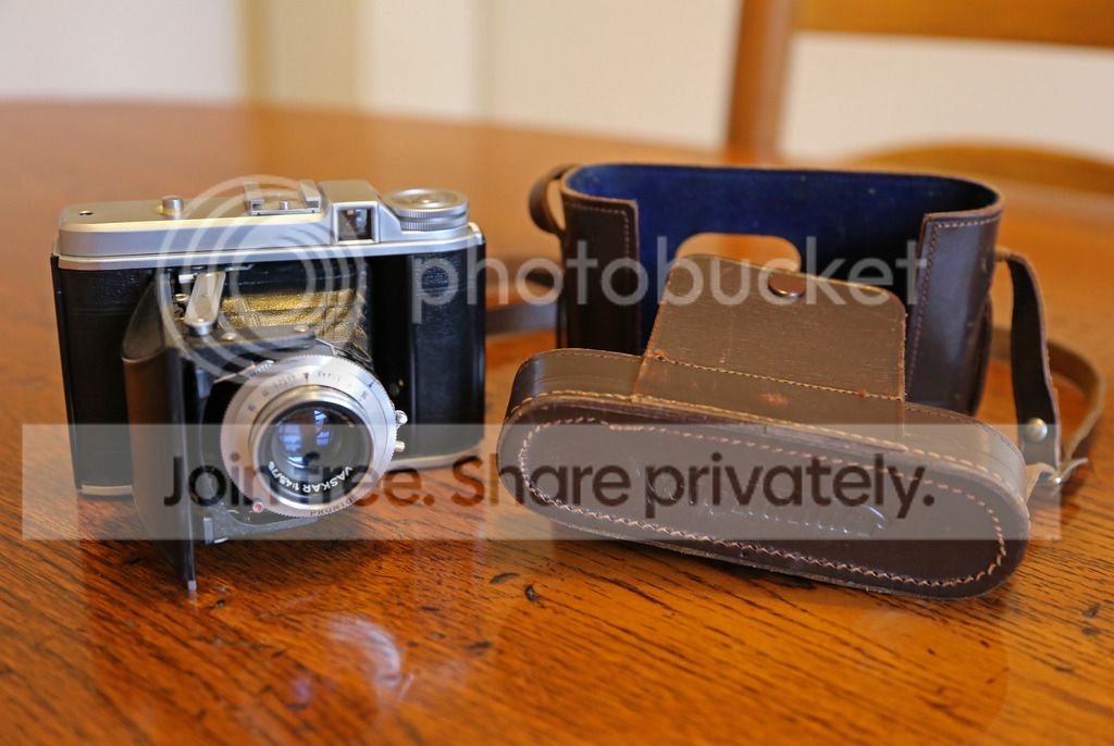

This one came to live with me today; it’s a Voigtlander Perkeo 1 dating (I think) from around 1951. The shutter and aperture seem to work fine, the bellows are lightproof and the lens elements are clear and scratch free, and it came complete with its leather case for less than £30, so I’m a happy badger!
For those not familiar with this camera, it has something in common with Dr Who’s Tardis; it appears to be bigger on the inside than it does on the outside! It takes 120 roll film and gives 12 6x6cm exposures, but looking at that film box next to it for scale you’d wonder how a roll of 120 fits in there. It’s roughly the same size as a 1970s 35mm SLR:
The serial number on the lens indicates (from a dating chart I found on the internet) that it was made between 1947 and 1951, which may be correct as I believe they started making them in '51. It has a back without a closable door on the film counter window and no film roller on the loading chamber side, but has an anti double-exposure lock, which I’ve read came in later (1952), so perhaps it's a cross-over spec model? If anyone knows when the spec changes occurred then please let me know.
It’s been loaded with fresh XP2 and, as you’ll see from the film counter window, half of that’s gone already, so I should have some test results to look at by the end of next week, wish me luck! Thanks for reading.
