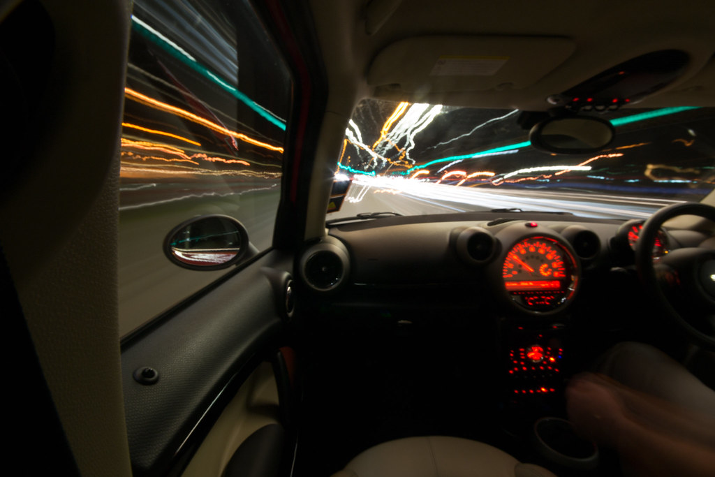

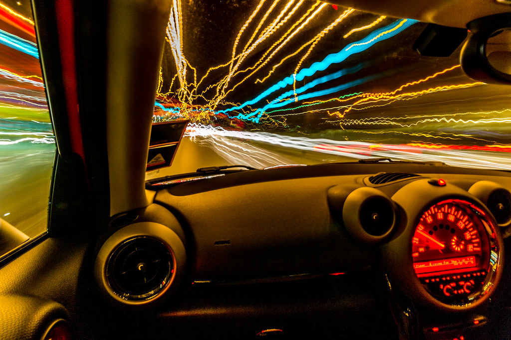

View attachment 3534 Full Frame, 20mm at f10 @ 30sec ,ISO 200.Camera on tripod one leg in foot area other two legs either side of the seat.Make sure there are traffic lights about to get the colours.Manual mode.
Thanks Kestral thats the sort of shot I'm looking for.
Never thought about traffic liights, did you light the interior?
Loving that shot Kestral
I'd say Kestral never lit the interior judging by the direction of the lighting. Looks more like the outside ambient light and console doing all the work.
May give this a go myself.... How hard can it be! Lol
It is just ambient light.Make sure you clean the windscreen inside and out also remove the tax disc :whistle:

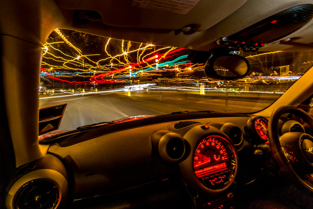

I got some very strange results.This effect was created by traveling along a duel carriage way with light stands in the middle of the road then the road dipped half way through the exposure.

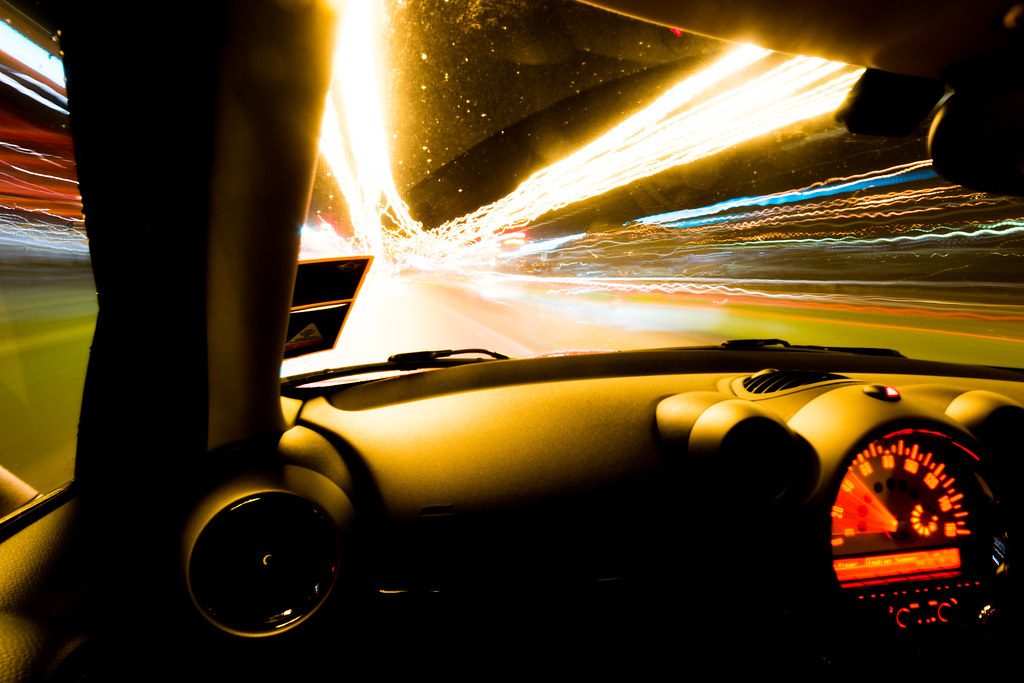

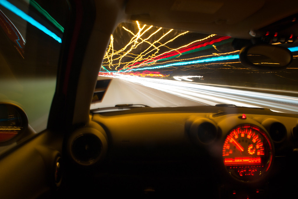

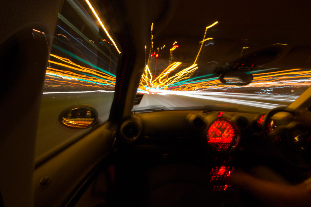

Well I had a play tonight just loading the pictures on to the computer will upload them shortly.
Tried two approaches first using a clamp to the head rear support then putting the camera between the top of the seat and base of the head rest.
Some very long exposures my finger is now dropping off
First attempt short exposure to test (using clmap)
DSC_0348
by MARKGAMESON1 (Downton Mini/Mini59), on Flickr
Next about 2 1/2 Minute exposure IMHO to much shake (using clamp)
DSC_0349
Next Just over 5 Minute Exposure again to much shake (using clamp)
DSC_0350
Next another short exsposure (camera between seat and head rest)
DSC_0350
A Bit better
DSC_0353
5 minutes is way to long on an exposure at normal driving speeds...if you want to do exposures that long your going to have to slow the car to walking pace, if you want to do it at normal speeds then your really looking at 30 seconds tops and as I've said you need to get the camera firmly secure in the car..you are using a trigger?
All the ones with the interior nor sharp look awful IMHO. Shorter exposure ftw!

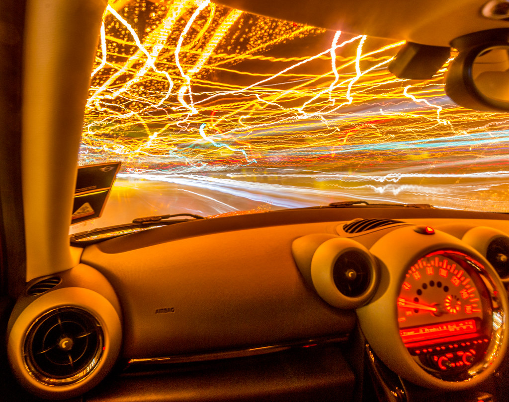

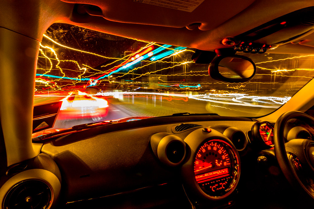

A friend and I had an improptu go at this one evening.
Camera is hand held, but supported by the passenger seat. Interior is lit by a flash on low intensity but wide spread from the passenger footwell.
I've been meaning to try this again with a tripod.
